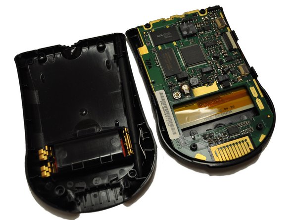

    • Using a T-5 Torx screwdriver, remove all four screws located on the back of the device. Turn counterclockwise to remove screws. The link to purchase this screwdriver is located at the top of this page.
    • Once you have removed all four screws, the device will be in three separate pieces (the back, the computer, and the button board).
    • Take caution as the power button will become loose after this step is completed.

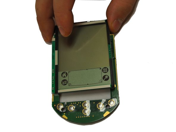

    • After step four, locate the button board. The button board should have a frame attached to it. Remove this frame.
    • To remove the buttons from the frame, apply even pressure on two buttons at a time. This should make them pop out easily. Once you have removed the buttons, you can now wash or replace them.
    • To insert a new set of buttons, push it back into the opening on the faceplate, and you should feel it click into place.
