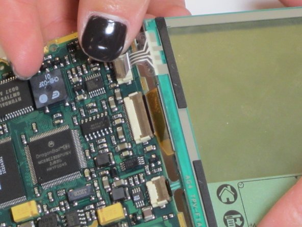

  4. Palm m 100 Display Screen Replacement: crwdns2935265:04crwdnd2935265:01crwdnd2935265:01crwdne2935265:0
    • Carefully lift up the circuit board, which will also lift up the screen. Do so carefully to prevent breaking the connectors.
    • Lift the left side of the circuit board and open it as though it were a book.
  5. Palm m 100 Display Screen Replacement: crwdns2935265:05crwdnd2935265:01crwdnd2935265:02crwdne2935265:0 Palm m 100 Display Screen Replacement: crwdns2935265:05crwdnd2935265:02crwdnd2935265:02crwdne2935265:0
    • Unplug the three connectors located on the right side of the circuit board with great caution and care.
    • Slide the cables out gently using a spudger
    • Separate the screen from the board.
