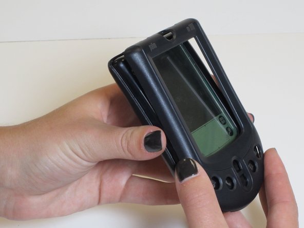

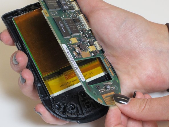

    • Remove rear cover by gently lifting it up from the bottom. To remove the front cover, flip the device over, and then separate the screen/circuit board from the cover.
  4. Palm m 100 Cover Replacement: crwdns2935265:04crwdnd2935265:01crwdnd2935265:01crwdne2935265:0
    • Set aside broken cover, and replace with a new cover.
  5. Palm m 100 Cover Replacement: crwdns2935265:05crwdnd2935265:01crwdnd2935265:01crwdne2935265:0
    • Close again like a book, and lay it gently into the front panel. Make sure the screen is facing outwards of the front panel.
