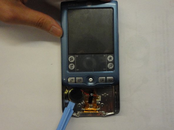

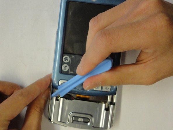

  4. Palm Zire 71 Motherboard/Screen Replacement, Front Panel Removal: crwdns2935265:04crwdnd2935265:01crwdnd2935265:02crwdne2935265:0 Palm Zire 71 Motherboard/Screen Replacement, Front Panel Removal: crwdns2935265:04crwdnd2935265:02crwdnd2935265:02crwdne2935265:0
    • Flip the device over so it's facing screen-side up.
    • Slide the screen upward by a few millimeters without detaching the screen - just enough to expose the top edge of the metallic panel so that you can reach underneath.
    • Avoid pulling up too far - there's a fragile ribbon cable underneath the panel!
    • Use the plastic opening tool to pry off the front panel.
    • This part is tricky, especially if you want to avoid damaging the panel. Opening picks are quite handy here; try inserting them in the seam at the bottom of the device, and working them around. You may also find it helpful to squeeze the sides of the device to release the sides of the front panel.

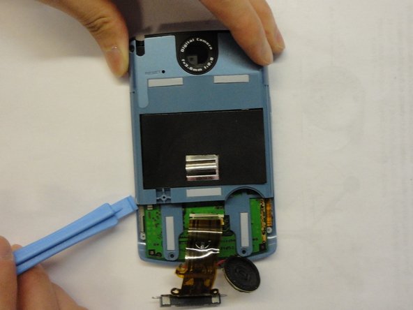

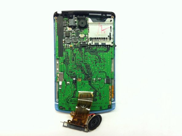

  6. Palm Zire 71 Motherboard/Screen Replacement, Back Cover: crwdns2935265:06crwdnd2935265:01crwdnd2935265:02crwdne2935265:0 Palm Zire 71 Motherboard/Screen Replacement, Back Cover: crwdns2935265:06crwdnd2935265:02crwdnd2935265:02crwdne2935265:0
    • Gently lift the ribbon cable off of the lower panel. If necessary, work the opening tool (or picks) underneath the cable to loosen it from the small tabs on the lower panel, and any glue that may be hiding underneath.
    • Avoid separating the ribbon cable from the interior of the device, and avoid separating the supportive material from the rest of the ribbon cable itself.
    • Slide the back cover off.

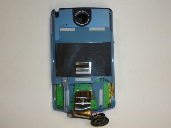

  7. Palm Zire 71 Motherboard/Screen Replacement, Battery: crwdns2935265:07crwdnd2935265:01crwdnd2935265:01crwdne2935265:0
    • Remove the Philips #00 screw
    • Remove the sliver metal piece

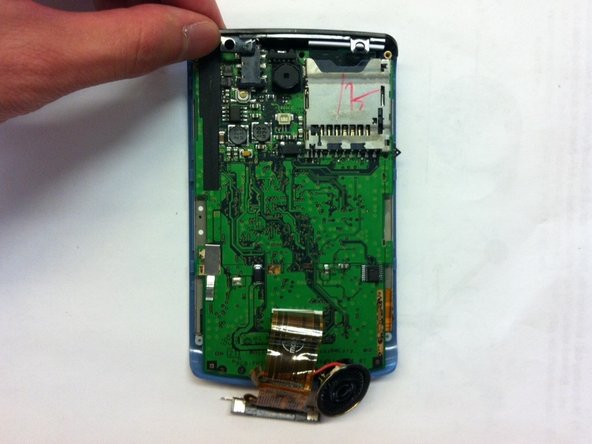

  8. Palm Zire 71 Motherboard/Screen Replacement: crwdns2935265:08crwdnd2935265:01crwdnd2935265:02crwdne2935265:0 Palm Zire 71 Motherboard/Screen Replacement: crwdns2935265:08crwdnd2935265:02crwdnd2935265:02crwdne2935265:0
    • Remove the Philips screws #00
    • Remove the rear blue panel by prying both sides using the plastic opening tool.
    • A small switch (which activates the camera) sits on the right-hand side. It is suggested to start prying the panel open on the left side. When reassembling, it may be easier to replace the rear blue panel starting on the right-hand side.

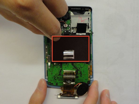

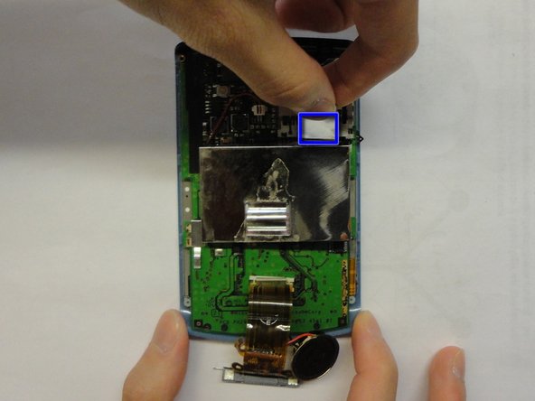

  9. Palm Zire 71 Motherboard/Screen Replacement: crwdns2935265:09crwdnd2935265:01crwdnd2935265:03crwdne2935265:0 Palm Zire 71 Motherboard/Screen Replacement: crwdns2935265:09crwdnd2935265:02crwdnd2935265:03crwdne2935265:0 Palm Zire 71 Motherboard/Screen Replacement: crwdns2935265:09crwdnd2935265:03crwdnd2935265:03crwdne2935265:0
    • Pull the tab up to remove the metal cap, which shields the battery.
    • Carefully lift the cap off the battery and logic board, being mindful of glue.

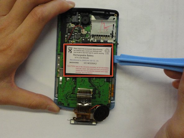

  10. Palm Zire 71 Motherboard/Screen Replacement: crwdns2935265:010crwdnd2935265:01crwdnd2935265:03crwdne2935265:0 Palm Zire 71 Motherboard/Screen Replacement: crwdns2935265:010crwdnd2935265:02crwdnd2935265:03crwdne2935265:0 Palm Zire 71 Motherboard/Screen Replacement: crwdns2935265:010crwdnd2935265:03crwdnd2935265:03crwdne2935265:0
    • Remove the cable by pinching the sides and pulling up. You can also use the opening tool to work it loose on each side.
    • Pry off the battery with the plastic opening tool.
    • It may be easier (and safer) to work some opening picks underneath the battery instead, working the glue loose until the battery comes free.
    • For reassembly, insert the (new) battery into the metal shield you removed earlier, then guide the shield back into its home position with the tabs on the right side of the shield and the logic board.

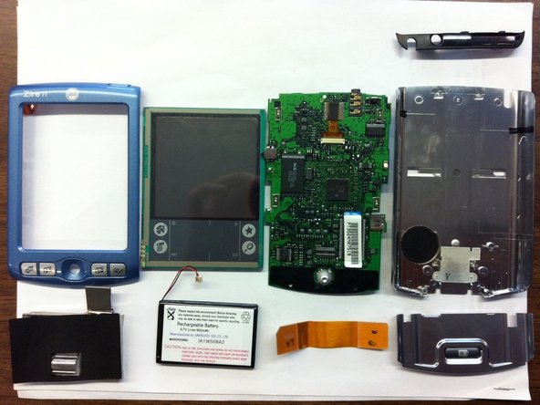

  11. Palm Zire 71 Motherboard/Screen Replacement, Motherboard/Screen: crwdns2935265:011crwdnd2935265:01crwdnd2935265:02crwdne2935265:0 Palm Zire 71 Motherboard/Screen Replacement, Motherboard/Screen: crwdns2935265:011crwdnd2935265:02crwdnd2935265:02crwdne2935265:0
    • Remove Philips screw #00
    • Remove black plastic top part

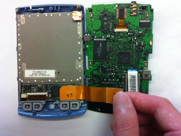

  12. Palm Zire 71 Motherboard/Screen Replacement: crwdns2935265:012crwdnd2935265:01crwdnd2935265:03crwdne2935265:0 Palm Zire 71 Motherboard/Screen Replacement: crwdns2935265:012crwdnd2935265:02crwdnd2935265:03crwdne2935265:0 Palm Zire 71 Motherboard/Screen Replacement: crwdns2935265:012crwdnd2935265:03crwdnd2935265:03crwdne2935265:0
    • Pull off the orange cable
    • Now the screen and the motherboard can be separated
    • Finished
