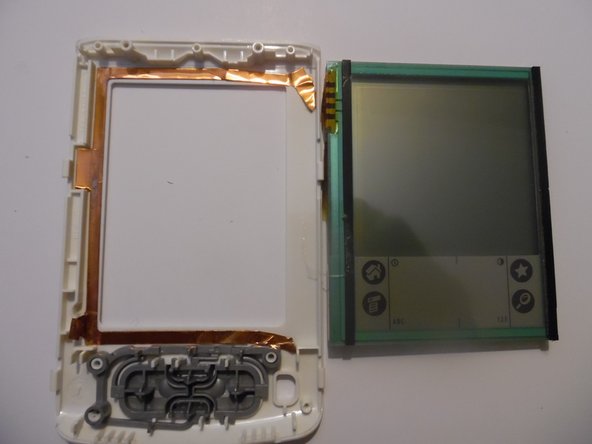

      • Remove the two 0.8mm screws located on the back of the device.
    2. Palm Zire 21 Screen Replacement: crwdns2935265:02crwdnd2935265:01crwdnd2935265:03crwdne2935265:0 Palm Zire 21 Screen Replacement: crwdns2935265:02crwdnd2935265:02crwdnd2935265:03crwdne2935265:0 Palm Zire 21 Screen Replacement: crwdns2935265:02crwdnd2935265:03crwdnd2935265:03crwdne2935265:0
      •  Using tweezers, or something similar flip up the tab, releasing the wires located under the flap
    3. Palm Zire 21 Screen Replacement: crwdns2935265:03crwdnd2935265:01crwdnd2935265:02crwdne2935265:0 Palm Zire 21 Screen Replacement: crwdns2935265:03crwdnd2935265:02crwdnd2935265:02crwdne2935265:0
      • Using a Philips head screwdriver, remove the two screws located at the bottom of the board.
    4. Palm Zire 21 Screen Replacement: crwdns2935265:04crwdnd2935265:01crwdnd2935265:02crwdne2935265:0 Palm Zire 21 Screen Replacement: crwdns2935265:04crwdnd2935265:02crwdnd2935265:02crwdne2935265:0
      • Gently, remove the motherboard by lifting up exposing the screen.
    5. Palm Zire 21 Screen Replacement: crwdns2935265:05crwdnd2935265:01crwdnd2935265:02crwdne2935265:0 Palm Zire 21 Screen Replacement: crwdns2935265:05crwdnd2935265:02crwdnd2935265:02crwdne2935265:0
      • Carefully, remove the screen from the device by lifting up and replacing with a new one.
