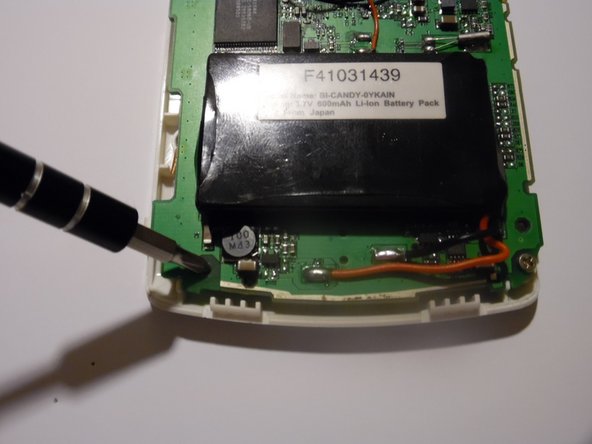

      • Remove the two screws located at the bottom of the mothership, using a Philips head screwdriver.
    4. Palm Zire 21 Keypad Replacement: crwdns2935265:04crwdnd2935265:01crwdnd2935265:01crwdne2935265:0
      • Carefully remove the mother board by lifting up, exposing the keypad.

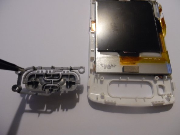

    5. Palm Zire 21 Keypad Replacement: crwdns2935265:05crwdnd2935265:01crwdnd2935265:02crwdne2935265:0 Palm Zire 21 Keypad Replacement: crwdns2935265:05crwdnd2935265:02crwdnd2935265:02crwdne2935265:0
      • Using tweezers, or something similar remove the keypad from the device and replace with a new one.
