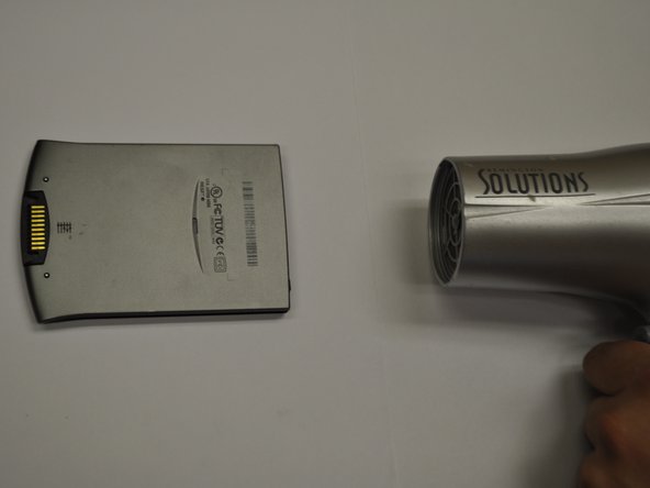

    • Lay device face down on surface.
  3. Palm Vx Screen Replacement: crwdns2935265:03crwdnd2935265:01crwdnd2935265:02crwdne2935265:0 Palm Vx Screen Replacement: crwdns2935265:03crwdnd2935265:02crwdnd2935265:02crwdne2935265:0
    • Heat each side for 30 seconds individually.
    • Note: Be aware not to heat the screen, or any part to the point of damage.
    • Caution: Heating the metal case may cause burns.

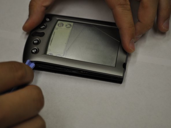

  4. Palm Vx Screen Replacement: crwdns2935265:04crwdnd2935265:01crwdnd2935265:03crwdne2935265:0 Palm Vx Screen Replacement: crwdns2935265:04crwdnd2935265:02crwdnd2935265:03crwdne2935265:0 Palm Vx Screen Replacement: crwdns2935265:04crwdnd2935265:03crwdnd2935265:03crwdne2935265:0
    • Pry off each side individually using a plastic pry bar.
    • Note: Using a plastic pry bar will keep from damaging the case. DO NOT use a metal screwdriver or similar tool.
    • Repeat for front and back of PDA.
    • Note: Do not lose the green power button that may fall out.

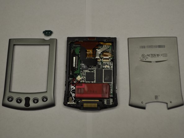

  5. Palm Vx Screen Replacement: crwdns2935265:05crwdnd2935265:01crwdnd2935265:01crwdne2935265:0
    • Remove the screen from the plastic casing.

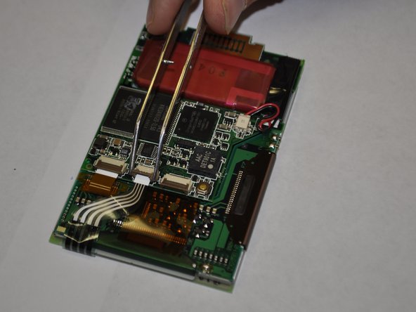

  6. Palm Vx Screen Replacement: crwdns2935265:06crwdnd2935265:01crwdnd2935265:02crwdne2935265:0 Palm Vx Screen Replacement: crwdns2935265:06crwdnd2935265:02crwdnd2935265:02crwdne2935265:0
    • In order to seperate the screen from the motherboard you must disconnect the ribbon attached to the screen.
    • To do this, using tweezers, flip up the cable clamp that is connecting the ribbon to the screen.
    • Once the clamp is up you can use the tweezers to gently detach the ribbon.
  7. Palm Vx Screen Replacement: crwdns2935265:07crwdnd2935265:01crwdnd2935265:01crwdne2935265:0
    • Now you must flip up the adjacent clamp as well, using tweezers like before.
    • After the clamp is flipped you can gently remove the second ribbon with tweezers.

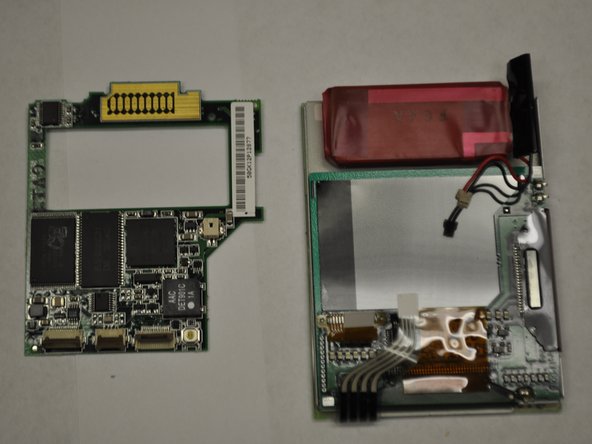

  8. Palm Vx Screen Replacement: crwdns2935265:08crwdnd2935265:01crwdnd2935265:01crwdne2935265:0
    • Before removing the screen you must detach one more wire, the battery connector.
    • Using the tweezers, squeeze the connector attached to the wire and genlty pull.
    • Do not pull on the wire.
  9. Palm Vx Screen Replacement: crwdns2935265:09crwdnd2935265:01crwdnd2935265:02crwdne2935265:0 Palm Vx Screen Replacement: crwdns2935265:09crwdnd2935265:02crwdnd2935265:02crwdne2935265:0
    • Now that both ribbons and the wire are disconeccted, you can apply a downward pressure to the battery. You will have to carefully rotate the frame so that the battery can go through.
