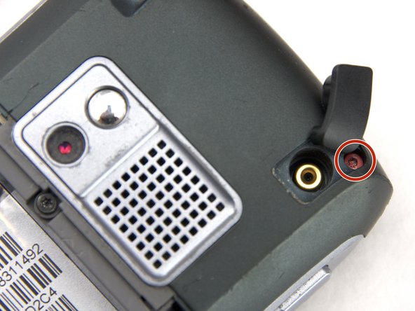

  3. Palm Treo 755p Keyboard Replacement, Back Cover: crwdns2935265:03crwdnd2935265:01crwdnd2935265:02crwdne2935265:0 Palm Treo 755p Keyboard Replacement, Back Cover: crwdns2935265:03crwdnd2935265:02crwdnd2935265:02crwdne2935265:0
    • Remove the stylus by pulling up on the large top to reveal the top left case screw.
    • Pull away the black flap to reveal the top right case screw.
  4. Palm Treo 755p Keyboard Replacement: crwdns2935265:04crwdnd2935265:01crwdnd2935265:01crwdne2935265:0
    • Use a T5 screwdriver to remove the five 7 mm black/red back case screws.
    • Use a T5 screwdriver to remove the middle 3.1 mm screw.

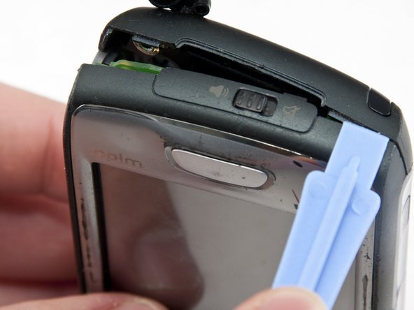

    • Use the plastic opening tool to pry open the device. Start on the volume control side (left side of the screen) and work your way up along the edge and across the top.
    • The side volume control buttons may fall out after opening the device.

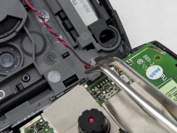

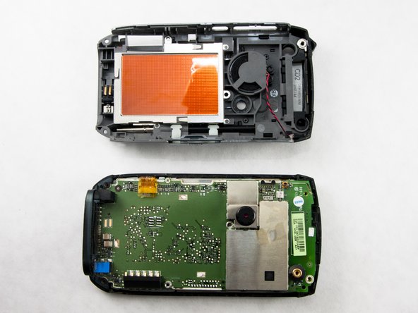

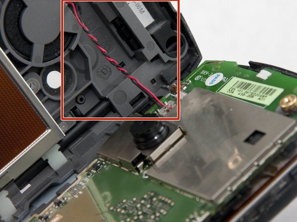

  6. Palm Treo 755p Keyboard Replacement: crwdns2935265:06crwdnd2935265:01crwdnd2935265:02crwdne2935265:0 Palm Treo 755p Keyboard Replacement: crwdns2935265:06crwdnd2935265:02crwdnd2935265:02crwdne2935265:0
    • Slowly unfold the back casing away from the front casing revealing the red and black wound wire speaker cable, marked by the red box.
    • Potential for device damage: Be gentle while separating the halves to prevent breaking the red and black wound wire speaker cable that bridges both halves.
  7. Palm Treo 755p Keyboard Replacement: crwdns2935265:07crwdnd2935265:01crwdnd2935265:03crwdne2935265:0 Palm Treo 755p Keyboard Replacement: crwdns2935265:07crwdnd2935265:02crwdnd2935265:03crwdne2935265:0 Palm Treo 755p Keyboard Replacement: crwdns2935265:07crwdnd2935265:03crwdnd2935265:03crwdne2935265:0
    • Using tweezers, squeeze the plastic head of the black and red wound wire cable. This will detach the cable from the circuit board and fully separate the two halves.

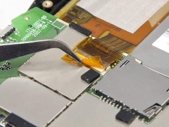

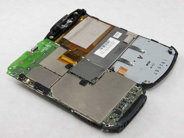

  8. Palm Treo 755p Keyboard Replacement, Circuit Board: crwdns2935265:08crwdnd2935265:01crwdnd2935265:01crwdne2935265:0
    • Gently peel off the protective yellow tape covering the ribbon cable using tweezers or your fingers.
    • ATTENTION: Save the tape for reassembly.

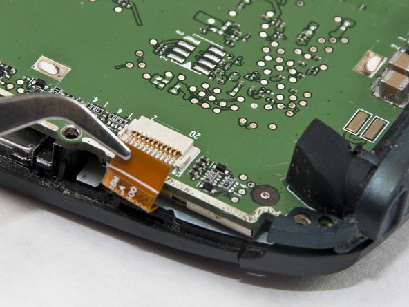

  9. Palm Treo 755p Keyboard Replacement: crwdns2935265:09crwdnd2935265:01crwdnd2935265:02crwdne2935265:0 Palm Treo 755p Keyboard Replacement: crwdns2935265:09crwdnd2935265:02crwdnd2935265:02crwdne2935265:0
    • Using tweezers flip up the black plastic snap covering the small ribbon cable.
    • Using tweezers gently pull out the ribbon cable to detach it from the circuit board.
  10. Palm Treo 755p Keyboard Replacement: crwdns2935265:010crwdnd2935265:01crwdnd2935265:01crwdne2935265:0
    • With the screen facing down. Use the Phillips 00 screwdriver attachment to remove the silver, 0.124 inch long screw on the left side of the circuit board above the ribbon cable.
    • WARNING: Do not over-tighten the screw during reassembly.
  11. Palm Treo 755p Keyboard Replacement: crwdns2935265:011crwdnd2935265:01crwdnd2935265:03crwdne2935265:0 Palm Treo 755p Keyboard Replacement: crwdns2935265:011crwdnd2935265:02crwdnd2935265:03crwdne2935265:0 Palm Treo 755p Keyboard Replacement: crwdns2935265:011crwdnd2935265:03crwdnd2935265:03crwdne2935265:0
    • Pivot the circuit board away from the casing keeping the screen face down.
    • Gently peel away the tape holding the ribbon cable to the screen.

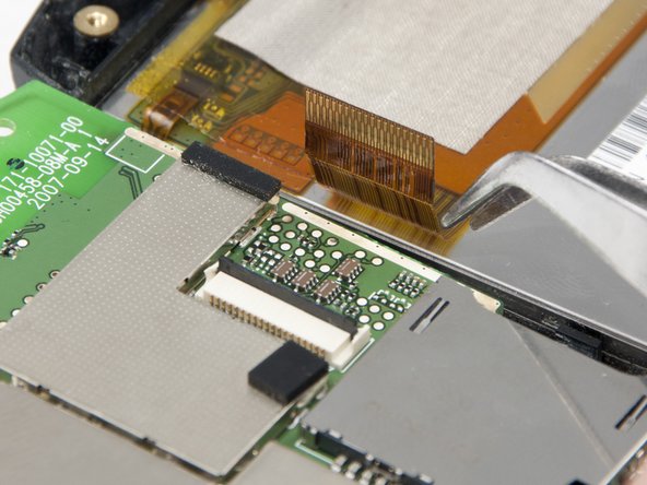

  12. Palm Treo 755p Keyboard Replacement: crwdns2935265:012crwdnd2935265:01crwdnd2935265:02crwdne2935265:0 Palm Treo 755p Keyboard Replacement: crwdns2935265:012crwdnd2935265:02crwdnd2935265:02crwdne2935265:0
    • Using tweezers flip up the black plastic snap covering the ribbon cable attached to the screen.
    • Gently pull out the ribbon cable freeing the circuit board from the casing.

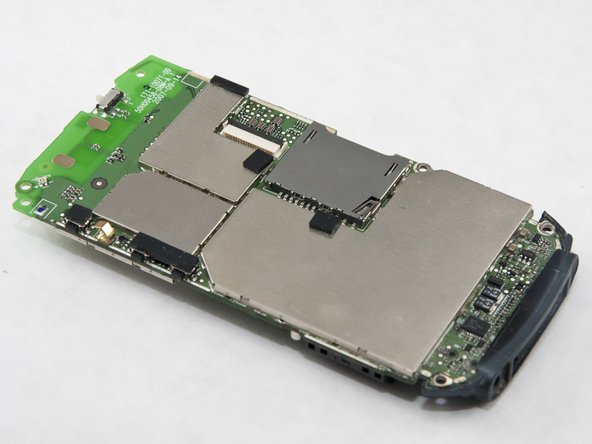

  13. Palm Treo 755p Keyboard Replacement: crwdns2935265:013crwdnd2935265:01crwdnd2935265:02crwdne2935265:0 Palm Treo 755p Keyboard Replacement: crwdns2935265:013crwdnd2935265:02crwdnd2935265:02crwdne2935265:0
    • Separate the circuit board from front cover.
  14. Palm Treo 755p Keyboard Replacement, Screen: crwdns2935265:014crwdnd2935265:01crwdnd2935265:02crwdne2935265:0 Palm Treo 755p Keyboard Replacement, Screen: crwdns2935265:014crwdnd2935265:02crwdnd2935265:02crwdne2935265:0

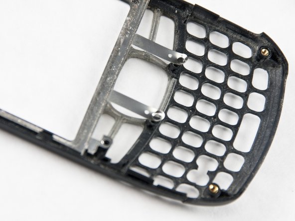

  15. Palm Treo 755p Keyboard Replacement, Keyboard: crwdns2935265:015crwdnd2935265:01crwdnd2935265:01crwdne2935265:0
    • Using the Phillips 00 screwdriver attachment remove the two silver, 0.121 inch long screws connecting the keypad to the casing.
    • WARNING: Do not over-tighten the screws during reassembly or the keyboard will not work properly.

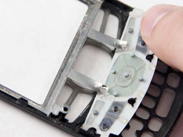

  16. Palm Treo 755p Keyboard Replacement: crwdns2935265:016crwdnd2935265:01crwdnd2935265:01crwdne2935265:0
    • Lift the metal keyboard backing from underneath the metal straps and slide it out backwards away from the casing.
  17. Palm Treo 755p Keyboard Replacement: crwdns2935265:017crwdnd2935265:01crwdnd2935265:01crwdne2935265:0
    • Lift up and remove the transparent rubber key liner.
