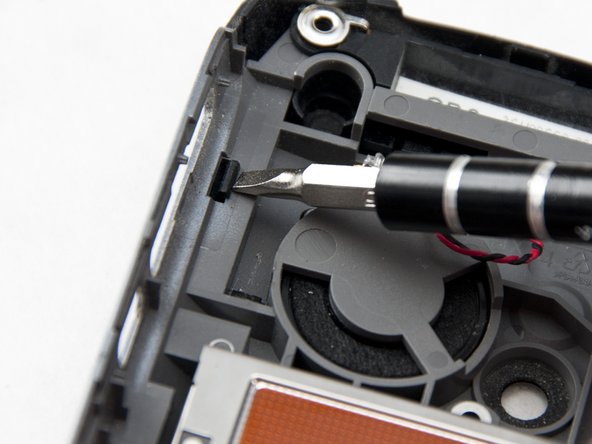

  9. Palm Treo 755p Antenna Replacement: crwdns2935265:09crwdnd2935265:01crwdnd2935265:02crwdne2935265:0 Palm Treo 755p Antenna Replacement: crwdns2935265:09crwdnd2935265:02crwdnd2935265:02crwdne2935265:0
    • Press in the four black clips using a spudger to pop off the upper-back cover.

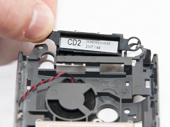

  10. Palm Treo 755p Antenna Replacement: crwdns2935265:010crwdnd2935265:01crwdnd2935265:01crwdne2935265:0
    • Lift off the top of the back cover from the phone frame.
  11. Palm Treo 755p Antenna Replacement: crwdns2935265:011crwdnd2935265:01crwdnd2935265:02crwdne2935265:0 Palm Treo 755p Antenna Replacement: crwdns2935265:011crwdnd2935265:02crwdnd2935265:02crwdne2935265:0
    • Gently pop off the antenna by pulling it away from the back cover.
