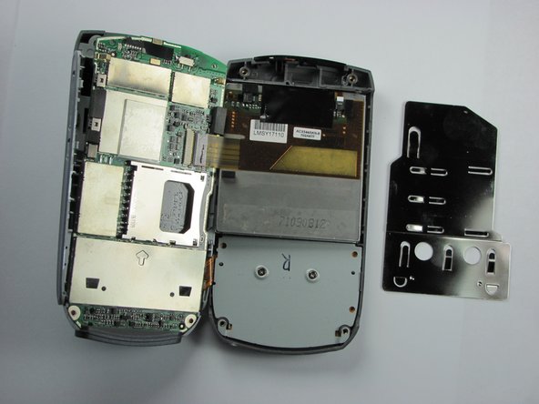

  7. Palm Treo 680 Motherboard Replacement, Motherboard: crwdns2935265:07crwdnd2935265:01crwdnd2935265:02crwdne2935265:0 Palm Treo 680 Motherboard Replacement, Motherboard: crwdns2935265:07crwdnd2935265:02crwdnd2935265:02crwdne2935265:0
    • Slide the slim metal plate upwards until it disconnects from the motherboard.
    • DO NOT bend or crinkle this metal plate. It will be VERY DIFFICULT, IF NOT IMPOSSIBLE, to slide it back into place when you are re-assembling if you bend or crinkle this metal plate.

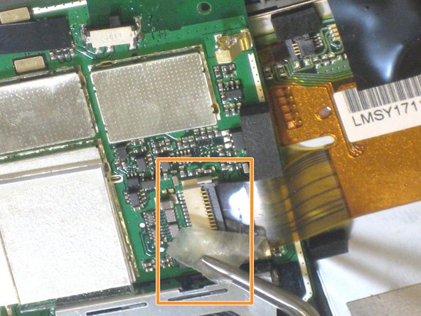

    • Locate the orange ribbon that connects the screen to the motherboard.
    • Use tweezers to peel off the small piece of tape over the orange ribbon connector.

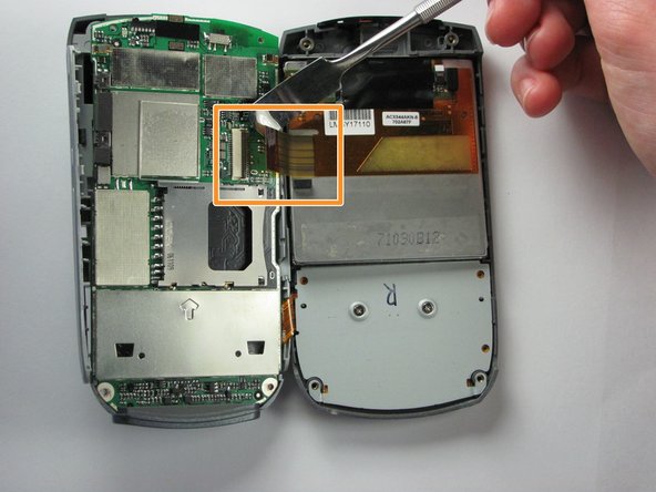

  9. Palm Treo 680 Motherboard Replacement: crwdns2935265:09crwdnd2935265:01crwdnd2935265:02crwdne2935265:0 Palm Treo 680 Motherboard Replacement: crwdns2935265:09crwdnd2935265:02crwdnd2935265:02crwdne2935265:0
    • Slide the spudger between the orange ribbon and black connector. Flip the black connector upwards to release the orange ribbon.
    • Using the spudger, pull the orange ribbon away from the connector to confirm the wire is fully disconnected.

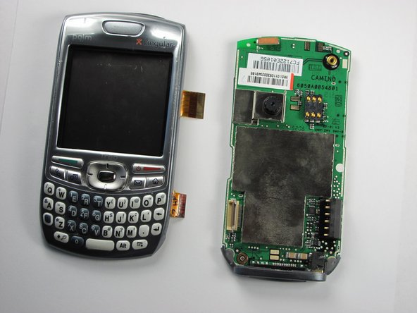

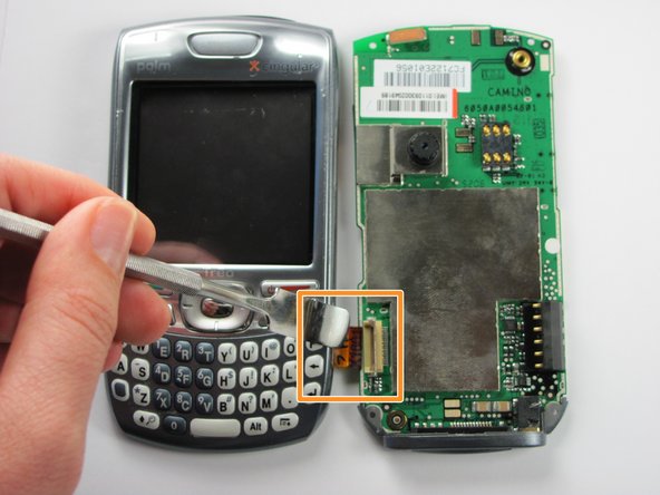

  10. Palm Treo 680 Motherboard Replacement: crwdns2935265:010crwdnd2935265:01crwdnd2935265:03crwdne2935265:0 Palm Treo 680 Motherboard Replacement: crwdns2935265:010crwdnd2935265:02crwdnd2935265:03crwdne2935265:0 Palm Treo 680 Motherboard Replacement: crwdns2935265:010crwdnd2935265:03crwdnd2935265:03crwdne2935265:0
    • Carefully turn the phone over so the screen is face up.
    • Locate the other orange ribbon that connects the motherboard to the faceplate.
    • Slide the spudger between the orange ribbon and tan connector. Lift the tan connector up to release the orange ribbon.
    • Separate the motherboard and faceplate of the Palm Treo.
