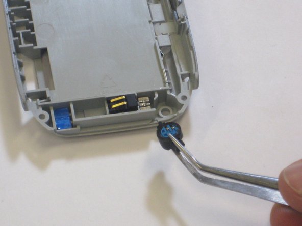

  7. Palm Treo 680 Microphone Replacement, Microphone: crwdns2935265:07crwdnd2935265:01crwdnd2935265:02crwdne2935265:0 Palm Treo 680 Microphone Replacement, Microphone: crwdns2935265:07crwdnd2935265:02crwdnd2935265:02crwdne2935265:0
    • Using a pair of tweezers, grasp the blue rubber microphone.
    • Pull the rubber microphone up and back to remove it.
    • Now you have successfully removed the microphone.
