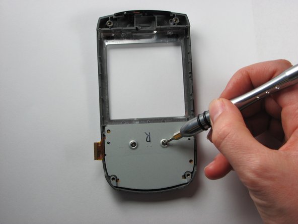

  11. Palm Treo 680 Keyboard Replacement, Keyboard: crwdns2935265:011crwdnd2935265:01crwdnd2935265:02crwdne2935265:0 Palm Treo 680 Keyboard Replacement, Keyboard: crwdns2935265:011crwdnd2935265:02crwdnd2935265:02crwdne2935265:0
    • Locate the backside of the Treo's faceplate.
    • Remove the two screws using the T6 Torx screwdriver.

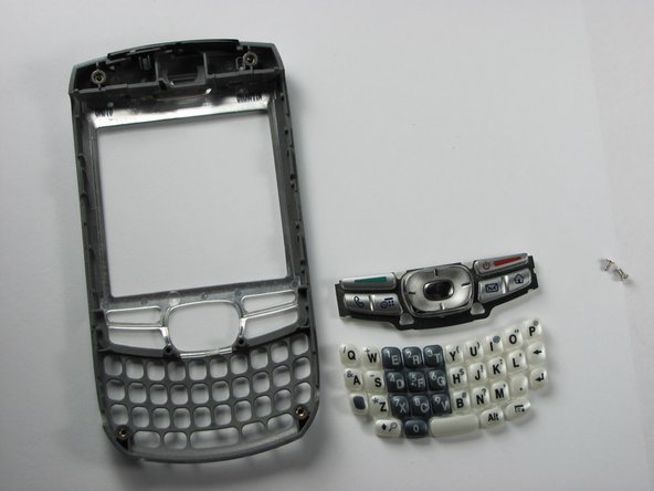

  12. Palm Treo 680 Keyboard Replacement: crwdns2935265:012crwdnd2935265:01crwdnd2935265:02crwdne2935265:0 Palm Treo 680 Keyboard Replacement: crwdns2935265:012crwdnd2935265:02crwdnd2935265:02crwdne2935265:0
    • Take off the plastic back panel, to gain access to the rubber keys of the keyboard.
    • Push on the keys and function bar from the front of the Treo. They should all pop right out.
