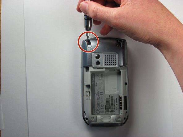

    1. Palm Treo 680 Back Panel Replacement, Back Panel: crwdns2935265:03crwdnd2935265:01crwdnd2935265:02crwdne2935265:0 Palm Treo 680 Back Panel Replacement, Back Panel: crwdns2935265:03crwdnd2935265:02crwdnd2935265:02crwdne2935265:0
      • Remove the stylus in order to access the screw.
      • Remove the 27mm top-left screw using a T6 Torx screwdriver.

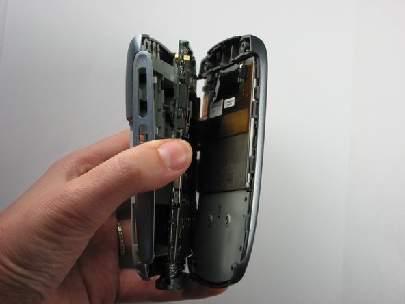

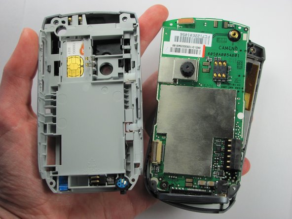

    4. Palm Treo 680 Back Panel Replacement: crwdns2935265:06crwdnd2935265:01crwdnd2935265:03crwdne2935265:0 Palm Treo 680 Back Panel Replacement: crwdns2935265:06crwdnd2935265:02crwdnd2935265:03crwdne2935265:0 Palm Treo 680 Back Panel Replacement: crwdns2935265:06crwdnd2935265:03crwdnd2935265:03crwdne2935265:0
      • Turn the phone so the screen is facing the right side.
      • Use a spudger to carefully separate the back panel from the front panel to access components inside the phone.
      • Separate the covers from the left side of the device as indicated in the picture.
      • The right side contains orange ribbons that are easily damaged.
