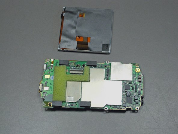

  8. Palm Treo 650 LCD Screen Replacement, Motherboard: crwdns2935265:08crwdnd2935265:01crwdnd2935265:03crwdne2935265:0 Palm Treo 650 LCD Screen Replacement, Motherboard: crwdns2935265:08crwdnd2935265:02crwdnd2935265:03crwdne2935265:0 Palm Treo 650 LCD Screen Replacement, Motherboard: crwdns2935265:08crwdnd2935265:03crwdnd2935265:03crwdne2935265:0
    • Disconnect the ribbon cable before removing the motherboard.
    • Unclip the gray tab.
    • Pull out the orange ribbon cable.
  9. Palm Treo 650 LCD Screen Replacement: crwdns2935265:09crwdnd2935265:01crwdnd2935265:02crwdne2935265:0 Palm Treo 650 LCD Screen Replacement: crwdns2935265:09crwdnd2935265:02crwdnd2935265:02crwdne2935265:0
    • Pull off the motherboard.

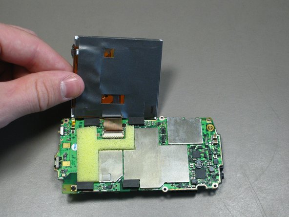

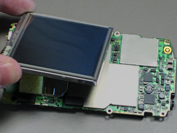

  10. Palm Treo 650 LCD Screen Replacement, LCD Screen: crwdns2935265:010crwdnd2935265:01crwdnd2935265:03crwdne2935265:0 Palm Treo 650 LCD Screen Replacement, LCD Screen: crwdns2935265:010crwdnd2935265:02crwdnd2935265:03crwdne2935265:0 Palm Treo 650 LCD Screen Replacement, LCD Screen: crwdns2935265:010crwdnd2935265:03crwdnd2935265:03crwdne2935265:0
    • Lift up the LCD screen so that the ribbon strip connecting it to the motherboard can be accessed.
    • Only lift the screen high enough to access the ribbon cable.
  11. Palm Treo 650 LCD Screen Replacement: crwdns2935265:011crwdnd2935265:01crwdnd2935265:02crwdne2935265:0 Palm Treo 650 LCD Screen Replacement: crwdns2935265:011crwdnd2935265:02crwdnd2935265:02crwdne2935265:0
    • Pull out the orange ribbon strip.
    • Remove the LCD screen.
