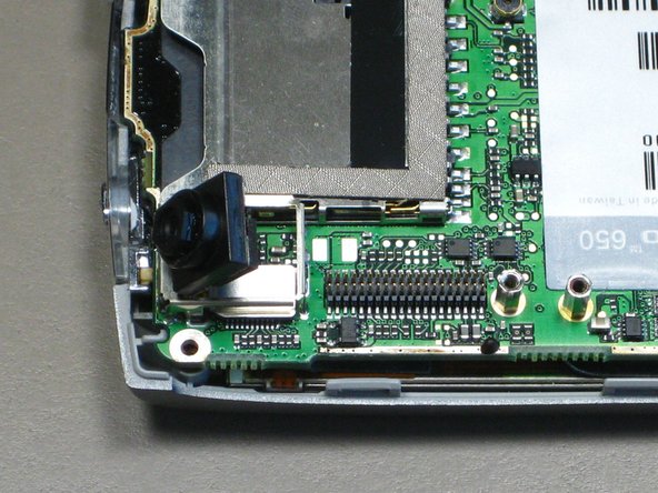

  8. Palm Treo 650 Camera Replacement, Camera: crwdns2935265:08crwdnd2935265:01crwdnd2935265:03crwdne2935265:0 Palm Treo 650 Camera Replacement, Camera: crwdns2935265:08crwdnd2935265:02crwdnd2935265:03crwdne2935265:0 Palm Treo 650 Camera Replacement, Camera: crwdns2935265:08crwdnd2935265:03crwdnd2935265:03crwdne2935265:0
    • Remove the two 3.75 mm screws.
    • Pull off the logic board.
  9. Palm Treo 650 Camera Replacement: crwdns2935265:09crwdnd2935265:01crwdnd2935265:03crwdne2935265:0 Palm Treo 650 Camera Replacement: crwdns2935265:09crwdnd2935265:02crwdnd2935265:03crwdne2935265:0 Palm Treo 650 Camera Replacement: crwdns2935265:09crwdnd2935265:03crwdnd2935265:03crwdne2935265:0
    • Pull the rubber ring off of the camera.
  10. Palm Treo 650 Camera Replacement: crwdns2935265:010crwdnd2935265:01crwdnd2935265:02crwdne2935265:0 Palm Treo 650 Camera Replacement: crwdns2935265:010crwdnd2935265:02crwdnd2935265:02crwdne2935265:0
    • Pry off the metal camera case.
    • Lift up the camera, but do not remove. The connector must be detatched first.
  11. Palm Treo 650 Camera Replacement: crwdns2935265:011crwdnd2935265:01crwdnd2935265:02crwdne2935265:0 Palm Treo 650 Camera Replacement: crwdns2935265:011crwdnd2935265:02crwdnd2935265:02crwdne2935265:0
    • Pry off the camera connector plug.
    • Remove the camera.
