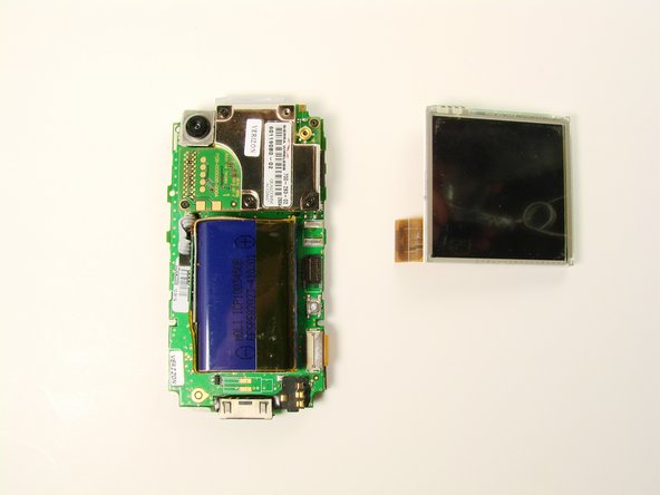

  5. Palm Treo 600 Screen Replacement, Screen: crwdns2935265:05crwdnd2935265:01crwdnd2935265:01crwdne2935265:0
    • The screen is connected to the phone with an orange data cable.
    • Slide the spudger as close to the connection as possible.
    • Gently pull the spudger up and the cable should come out of the socket.
  6. Palm Treo 600 Screen Replacement: crwdns2935265:06crwdnd2935265:01crwdnd2935265:02crwdne2935265:0 Palm Treo 600 Screen Replacement: crwdns2935265:06crwdnd2935265:02crwdnd2935265:02crwdne2935265:0
    • Once the cable is unplugged, you can remove the screen from the body.
