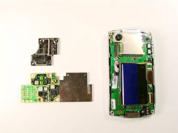

  4. Palm Treo 600 Logic Board Replacement, Motherboard: crwdns2935265:04crwdnd2935265:01crwdnd2935265:01crwdne2935265:0
    • Using the Phillips #00 screwdriver, unscrew the 4 screws holding the silver casing down.
  5. Palm Treo 600 Logic Board Replacement: crwdns2935265:05crwdnd2935265:01crwdnd2935265:01crwdne2935265:0
    • Lift up the silver casing.
    • Careful! The casing is connected to the body. Pull the casing up.
  6. Palm Treo 600 Logic Board Replacement: crwdns2935265:06crwdnd2935265:01crwdnd2935265:01crwdne2935265:0
    • With the silver casing removed, unscrew two black screws with a #00 Phillips Screwdriver.
  7. Palm Treo 600 Logic Board Replacement: crwdns2935265:07crwdnd2935265:01crwdnd2935265:02crwdne2935265:0 Palm Treo 600 Logic Board Replacement: crwdns2935265:07crwdnd2935265:02crwdnd2935265:02crwdne2935265:0
    • Use the spudger to lift the logic board from its socket. Remove it from the rest of the phone.
