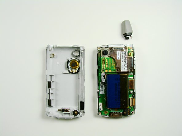

    • Using a plastic opening tool, carefully separate the front and back cases.
    • Note: The antenna will detach from the phone.

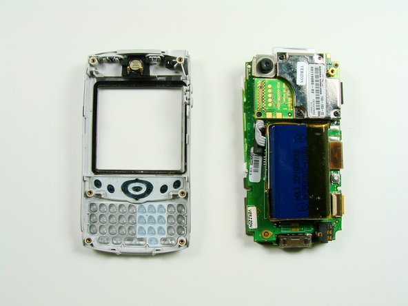

    • Using a T6 Torx Screwdriver, remove the two screws.
    • The motherboard will now be loose from the front case.
