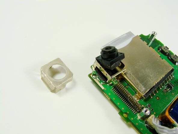

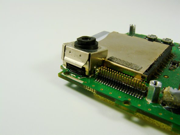

  8. Palm Treo 600 Camera Replacement, Camera: crwdns2935265:08crwdnd2935265:01crwdnd2935265:02crwdne2935265:0 Palm Treo 600 Camera Replacement, Camera: crwdns2935265:08crwdnd2935265:02crwdnd2935265:02crwdne2935265:0
    • Using the flat end of the spudger, lift the metal case off of the camera.

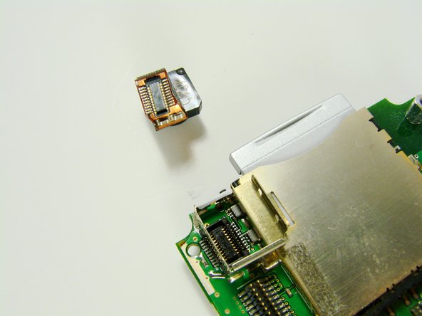

  9. Palm Treo 600 Camera Replacement: crwdns2935265:09crwdnd2935265:01crwdnd2935265:03crwdne2935265:0 Palm Treo 600 Camera Replacement: crwdns2935265:09crwdnd2935265:02crwdnd2935265:03crwdne2935265:0 Palm Treo 600 Camera Replacement: crwdns2935265:09crwdnd2935265:03crwdnd2935265:03crwdne2935265:0
    • Slide the flat end of the spudger between the printed circuit board and metal holder.
    • Pop the camera up
