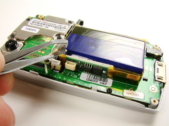

  4. Palm Treo 600 Battery Replacement, Battery: crwdns2935265:04crwdnd2935265:01crwdnd2935265:02crwdne2935265:0 Palm Treo 600 Battery Replacement, Battery: crwdns2935265:04crwdnd2935265:02crwdnd2935265:02crwdne2935265:0
    • Using metal tweezers, unplug small white plug.
    • Pulling the white plug will disconnect the battery. Make sure the phone is off before you do this step.
  5. Palm Treo 600 Battery Replacement: crwdns2935265:05crwdnd2935265:01crwdnd2935265:01crwdne2935265:0
    • Slide the flat side of the spudger under the battery and gently dislodge the battery by lifting the spudger up.
    • The battery may be glued to the phone.
