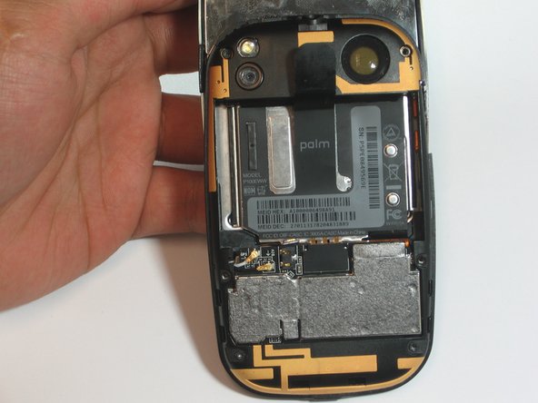

      • Make sure your Palm Pre is turned off before disassembling the phone.
      • Snap off the back panel to reveal the battery.
    2. Palm Pre Speaker Replacement: crwdns2935265:02crwdnd2935265:01crwdnd2935265:01crwdne2935265:0
      • Carefully pull up on the tab to remove the current battery.

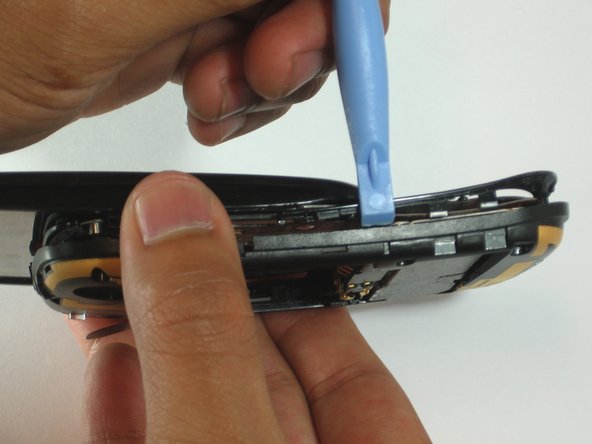

      • Use the spudger to locate the crease at the bottom of the keyboard.
      • Carefully work your way around the phone separating the back frame from the keyboard.
