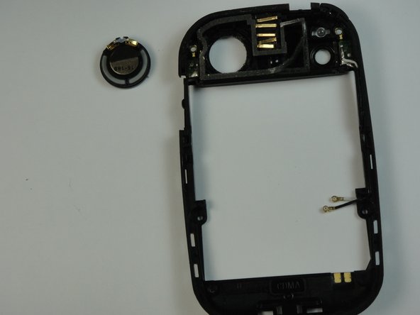

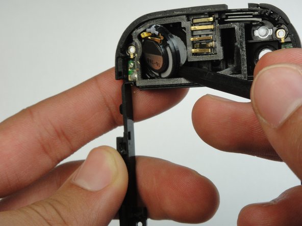

  4. Palm Pre Speaker Replacement, Speaker: crwdns2935265:04crwdnd2935265:01crwdnd2935265:03crwdne2935265:0 Palm Pre Speaker Replacement, Speaker: crwdns2935265:04crwdnd2935265:02crwdnd2935265:03crwdne2935265:0 Palm Pre Speaker Replacement, Speaker: crwdns2935265:04crwdnd2935265:03crwdnd2935265:03crwdne2935265:0
    • With the backplate removed, the speaker is visible.
    • Pry out speaker with spudger.
    • It is magnetically attached so there should be a little bit of resistance; however, there are no wires to disconnect.
    • Take note of the orientation of the speaker for re-installation.
