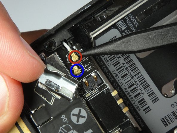

    3. Palm Pre Screen Assembly Replacement: crwdns2935265:03crwdnd2935265:01crwdnd2935265:02crwdne2935265:0 Palm Pre Screen Assembly Replacement: crwdns2935265:03crwdnd2935265:02crwdnd2935265:02crwdne2935265:0
      • Lift the metal flap marked in red to reveal the antenna connectors.
      • Carefully pry these the antennas from their connections, this can be done quite easily.
      • Take note of which colored wire is attached to each connection. The white wire corresponds to GPS, while the black wire corresponds to DIV, or diversity antenna.

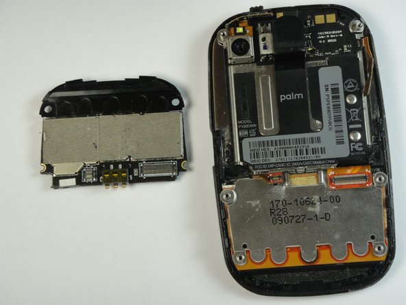

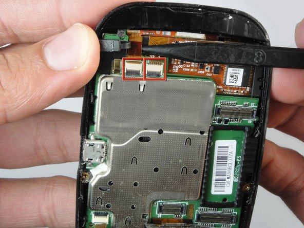

    1. Palm Pre Screen Assembly Replacement, PCB (Phone Circuit Board): crwdns2935265:04crwdnd2935265:01crwdnd2935265:03crwdne2935265:0 Palm Pre Screen Assembly Replacement, PCB (Phone Circuit Board): crwdns2935265:04crwdnd2935265:02crwdnd2935265:03crwdne2935265:0 Palm Pre Screen Assembly Replacement, PCB (Phone Circuit Board): crwdns2935265:04crwdnd2935265:03crwdnd2935265:03crwdne2935265:0
      • With the backplate removed, we have easy access to the PCB.
      • Two connectors must be disconnected so that we can remove the PCB.
      • Gentle prying with the opening tool should easily separate the glued PCB from the rest of the phone.

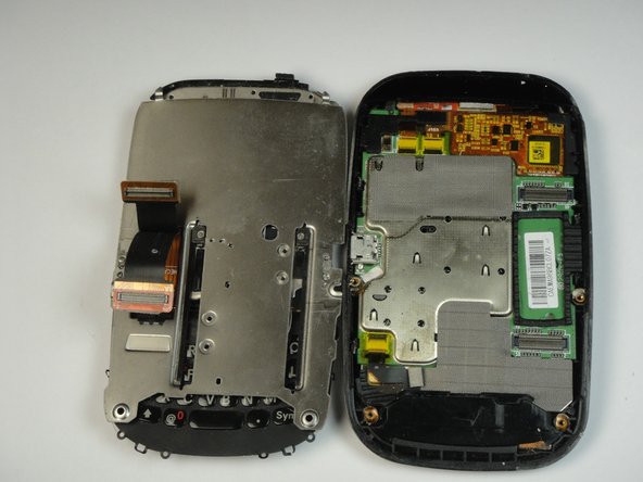

    1. Palm Pre Screen Assembly Replacement, Motherboard: crwdns2935265:05crwdnd2935265:01crwdnd2935265:01crwdne2935265:0
      • Once you have removed the PCB, you can proceed to removing the keyboard bezel.
      • To do this, use a spudger to gently lift off the plastic edging as shown. There are small plastic hooks attaching the bezel to the keyboard.
      • Be careful not to rip any of the loops on the keyboard.

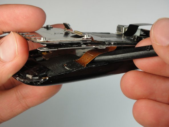

    2. Palm Pre Screen Assembly Replacement: crwdns2935265:06crwdnd2935265:01crwdnd2935265:03crwdne2935265:0 Palm Pre Screen Assembly Replacement: crwdns2935265:06crwdnd2935265:02crwdnd2935265:03crwdne2935265:0 Palm Pre Screen Assembly Replacement: crwdns2935265:06crwdnd2935265:03crwdnd2935265:03crwdne2935265:0
      • Now you are ready to pry the slider function from the back of the screen.
      • Remove the four screws. The bottom two screws are easier to see when the phone is slid about half open.
      • Again, use the spudger to pry around the edges loosening it until it comes apart.
      • There are several connectors still attaching these two pieces. Use the spudger to disconnect them on the screen.

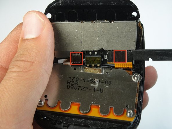

    3. Palm Pre Screen Assembly Replacement: crwdns2935265:07crwdnd2935265:01crwdnd2935265:02crwdne2935265:0 Palm Pre Screen Assembly Replacement: crwdns2935265:07crwdnd2935265:02crwdnd2935265:02crwdne2935265:0
      • Next, remove four connectors to remove the mother board.
      • Use a spudger to gently pry the four connectors.
      • There is a yellow film over some of the connectors that must be removed prior to removing the connections.
      • After everything is disconnected, the mother board should lift out easily.
