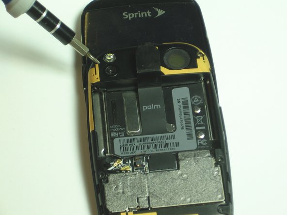

    1. Palm Pre Antenna Replacement, Antenna: crwdns2935265:03crwdnd2935265:01crwdnd2935265:02crwdne2935265:0 Palm Pre Antenna Replacement, Antenna: crwdns2935265:03crwdnd2935265:02crwdnd2935265:02crwdne2935265:0
      • Use the T5 Torx Screwdriver to remove the six screws holding the backing frame in place.

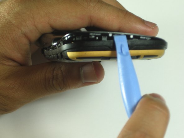

    3. Palm Pre Antenna Replacement: crwdns2935265:05crwdnd2935265:01crwdnd2935265:02crwdne2935265:0 Palm Pre Antenna Replacement: crwdns2935265:05crwdnd2935265:02crwdnd2935265:02crwdne2935265:0
      • Use a spudger to pry off the (black and yellow) back frame.
      • Disregard the main part of the phone at this point and look only at the inside of the removed back frame. (You will need the main part of the phone for access to the keyboard and motherboard)
