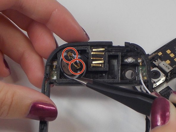

  5. Palm P101UNA Speaker Replacement: crwdns2935265:05crwdnd2935265:01crwdnd2935265:02crwdne2935265:0 Palm P101UNA Speaker Replacement: crwdns2935265:05crwdnd2935265:02crwdnd2935265:02crwdne2935265:0
    • Unplug the wire from the speaker using the tweezers.
  6. Palm P101UNA Speaker Replacement: crwdns2935265:06crwdnd2935265:01crwdnd2935265:01crwdne2935265:0
    • Pry out the speaker from the back of the phone using tweezers.
    • Applying pressure from the back of the speaker may help.
