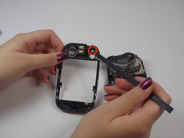

  5. Palm P101UNA Flash Bulb Replacement: crwdns2935265:05crwdnd2935265:01crwdnd2935265:02crwdne2935265:0 Palm P101UNA Flash Bulb Replacement: crwdns2935265:05crwdnd2935265:02crwdnd2935265:02crwdne2935265:0
    • Using your spudger, slowly apply pressure on the bulb until it comes loose.
