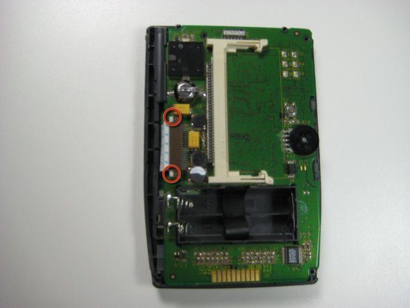

    • Position the device with the screen facing down.
    • Locate the white ribbon wire on the left hand side of the device.
    • On either side of the ribbon wire are two white clasps. Gently push the two clasps away from the board (to the left).

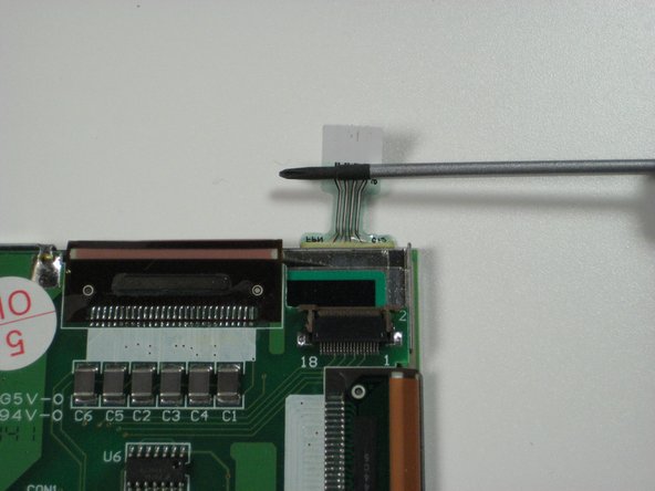

    • On the back of the screen near the top right corner is a plastic filament:
    • Gently lift up on the two brown clasps on either side of the filament connector as shown.
    • Using a thin, blunt object (a toothpick works well), slide it under the plastic filament and lift up to detach the filament from its connector.
