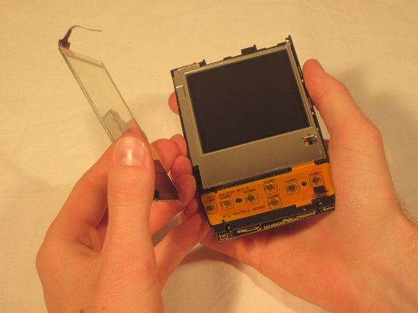

  4. Palm IIIc Screen Replacement, Screen: crwdns2935265:04crwdnd2935265:01crwdnd2935265:01crwdne2935265:0
    • Unhook the battery cable from the motherboard and remove the battery.
  5. Palm IIIc Screen Replacement: crwdns2935265:05crwdnd2935265:01crwdnd2935265:02crwdne2935265:0 Palm IIIc Screen Replacement: crwdns2935265:05crwdnd2935265:02crwdnd2935265:02crwdne2935265:0
    • On the back of the motherboard use tweezers to pull up the ZIF connector which looks like a brown plastic tab.
    • Once the ZIF connector is unattached, remove the clear screen cover.
  6. Palm IIIc Screen Replacement: crwdns2935265:06crwdnd2935265:01crwdnd2935265:01crwdne2935265:0
    • Using tweezers unhook the blue and red screen cables where they connect to the motherboard.
  7. Palm IIIc Screen Replacement: crwdns2935265:07crwdnd2935265:01crwdnd2935265:03crwdne2935265:0 Palm IIIc Screen Replacement: crwdns2935265:07crwdnd2935265:02crwdnd2935265:03crwdne2935265:0 Palm IIIc Screen Replacement: crwdns2935265:07crwdnd2935265:03crwdnd2935265:03crwdne2935265:0
    • Using tweezers, pull up the other two ZIF connector tabs.
  8. Palm IIIc Screen Replacement: crwdns2935265:08crwdnd2935265:01crwdnd2935265:01crwdne2935265:0
    • Gently pull the black clips on the inside case to detach the motherboard from the device. Pull the motherboard out towards the bottom left corner.
  9. Palm IIIc Screen Replacement: crwdns2935265:09crwdnd2935265:01crwdnd2935265:01crwdne2935265:0
    • Pull the screen out from the front.
