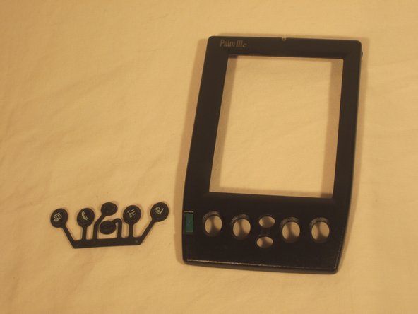

  4. Palm IIIc Button Pad Replacement, Button Pad: crwdns2935265:04crwdnd2935265:01crwdnd2935265:02crwdne2935265:0 Palm IIIc Button Pad Replacement, Button Pad: crwdns2935265:04crwdnd2935265:02crwdnd2935265:02crwdne2935265:0
    • Using a prying tool, carefully pop button pad out of the cover.
  5. Palm IIIc Button Pad Replacement: crwdns2935265:05crwdnd2935265:01crwdnd2935265:01crwdne2935265:0
    • Insert the new button pad where the old one used to be.
