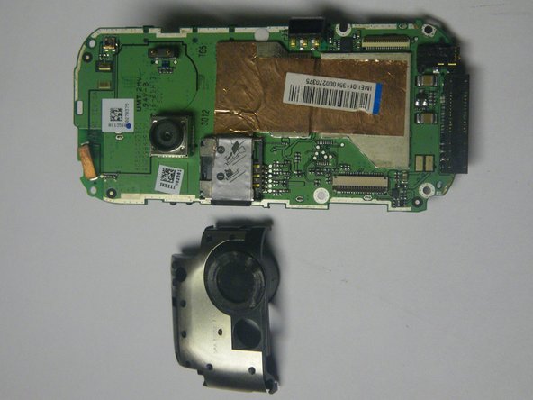

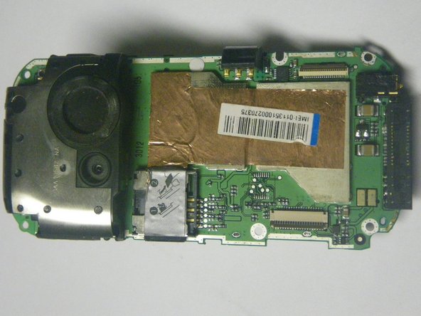

  12. Palm Centro Speakers Replacement: crwdns2935265:012crwdnd2935265:01crwdnd2935265:01crwdne2935265:0
    • Separate the logic board from the case by lifting and pulling out the bottom.
  13. Palm Centro Speakers Replacement, Speakers: crwdns2935265:013crwdnd2935265:01crwdnd2935265:03crwdne2935265:0 Palm Centro Speakers Replacement, Speakers: crwdns2935265:013crwdnd2935265:02crwdnd2935265:03crwdne2935265:0 Palm Centro Speakers Replacement, Speakers: crwdns2935265:013crwdnd2935265:03crwdnd2935265:03crwdne2935265:0
    • Pry the four plastic latches free that connect the antenna to the logic board.
    • Excessive force may damage your logic board!
    • Remove the antenna from the logic board.
  14. Palm Centro Speakers Replacement: crwdns2935265:014crwdnd2935265:01crwdnd2935265:01crwdne2935265:0
    • The internal speaker is attached to the antenna. To remove it, pry the speaker from the antenna using the tip of your screwdriver.
    • The speaker should be placed back into its spot in the correct position. Take notice of the gold connectors
