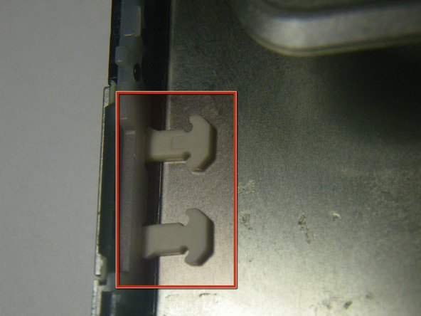

  14. Palm Centro Keyboard Replacement: crwdns2935265:014crwdnd2935265:01crwdnd2935265:02crwdne2935265:0 Palm Centro Keyboard Replacement: crwdns2935265:014crwdnd2935265:02crwdnd2935265:02crwdne2935265:0
    • Lift and slowly remove the screen from the front panel
    • Place the new screen into the front panel
    • Make sure the new screen goes in under the plastic tabs for the additional memory slot door or it may not close properly once the phone is put back together.
