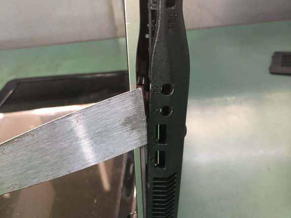

  3. Packard Bell ms-Hera c Disassembly, Unplug the cables: crwdns2935265:03crwdnd2935265:01crwdnd2935265:03crwdne2935265:0 Packard Bell ms-Hera c Disassembly, Unplug the cables: crwdns2935265:03crwdnd2935265:02crwdnd2935265:03crwdne2935265:0 Packard Bell ms-Hera c Disassembly, Unplug the cables: crwdns2935265:03crwdnd2935265:03crwdnd2935265:03crwdne2935265:0
    • Unplug the 3 connectors on the motherboard
    • Remove the 2 screws holding the display in place
    • Use a thin tool to pry up the back cover of the laptop on the side

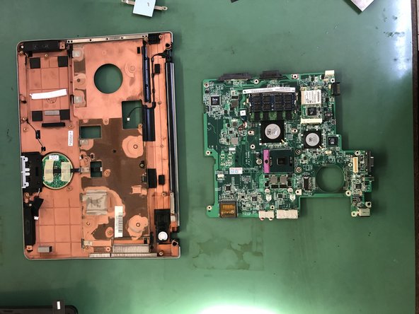

  4. Packard Bell ms-Hera c Disassembly, Unscrew the motherboard: crwdns2935265:04crwdnd2935265:01crwdnd2935265:03crwdne2935265:0 Packard Bell ms-Hera c Disassembly, Unscrew the motherboard: crwdns2935265:04crwdnd2935265:02crwdnd2935265:03crwdne2935265:0 Packard Bell ms-Hera c Disassembly, Unscrew the motherboard: crwdns2935265:04crwdnd2935265:03crwdnd2935265:03crwdne2935265:0
    • Remove the back cover.
    • Remove the HDD.
    • Remove the screws that hold the motherboard.

  7. Packard Bell ms-Hera c Disassembly, Remove the motherboard: crwdns2935265:07crwdnd2935265:01crwdnd2935265:02crwdne2935265:0 Packard Bell ms-Hera c Disassembly, Remove the motherboard: crwdns2935265:07crwdnd2935265:02crwdnd2935265:02crwdne2935265:0
    • Remove the screws to remove the motherboard.
