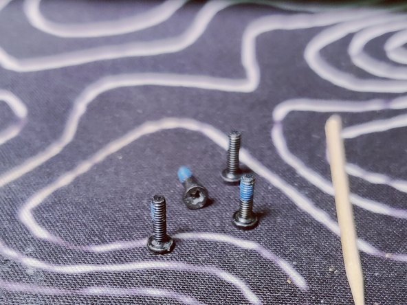

  3. Packard Bell EasyNote TJ65-CU-030GE hdd Replacement, opening the back cover: crwdns2935265:03crwdnd2935265:01crwdnd2935265:03crwdne2935265:0 Packard Bell EasyNote TJ65-CU-030GE hdd Replacement, opening the back cover: crwdns2935265:03crwdnd2935265:02crwdnd2935265:03crwdne2935265:0 Packard Bell EasyNote TJ65-CU-030GE hdd Replacement, opening the back cover: crwdns2935265:03crwdnd2935265:03crwdnd2935265:03crwdne2935265:0
    • start unscrewing
    • there should be 4 of them
    • next press the plastic near the DOOR RELEASE text while making sure there`s nothing preventing the rear door from opening
