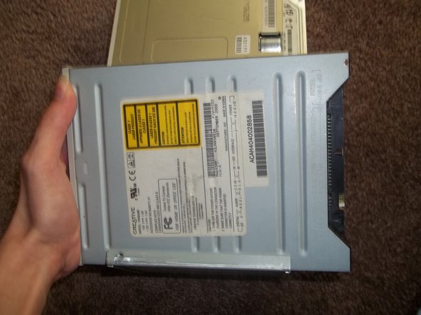

    1. Packard Bell 4X4 Desktop Optical Drive Replacement, Optical Drive: crwdns2935265:09crwdnd2935265:01crwdnd2935265:01crwdne2935265:0
      • Remove the 1 Philips head screw with your Phillips screwdriver. There should not be a screw in the right hole.
    2. Packard Bell 4X4 Desktop Optical Drive Replacement: crwdns2935265:010crwdnd2935265:01crwdnd2935265:02crwdne2935265:0 Packard Bell 4X4 Desktop Optical Drive Replacement: crwdns2935265:010crwdnd2935265:02crwdnd2935265:02crwdne2935265:0
      • Slide the optical drive forward and lift it up from the right side, the side closest to the floppy drive.
    3. Packard Bell 4X4 Desktop Optical Drive Replacement: crwdns2935265:011crwdnd2935265:01crwdnd2935265:01crwdne2935265:0
      • Remove the 2 Philips head screws with your Philips screwdriver. Put these screws onto your new optical drive.
