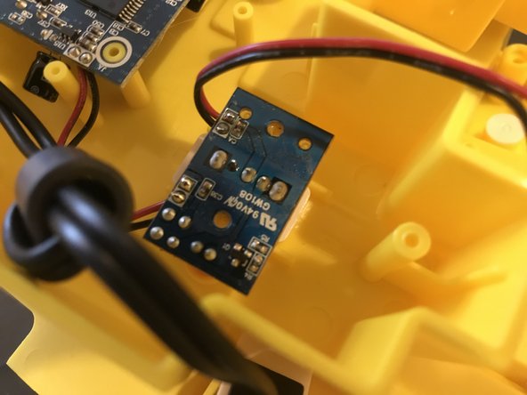

  4. Pac-Man Connect and Play Power Switch Replacement: crwdns2935265:04crwdnd2935265:01crwdnd2935265:02crwdne2935265:0 Pac-Man Connect and Play Power Switch Replacement: crwdns2935265:04crwdnd2935265:02crwdnd2935265:02crwdne2935265:0
    • Remove these 2 screws (Phillips)

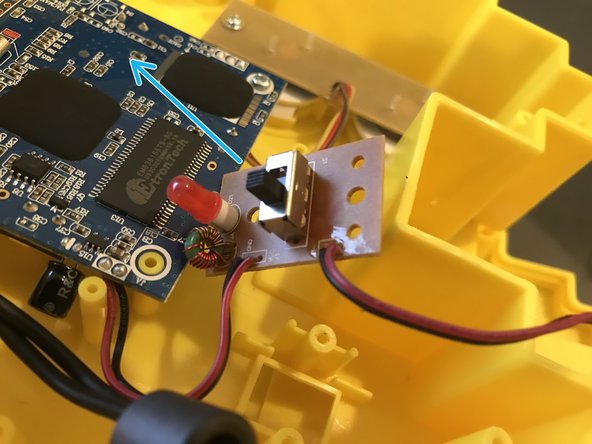

  5. Pac-Man Connect and Play Power Switch Replacement: crwdns2935265:05crwdnd2935265:01crwdnd2935265:02crwdne2935265:0 Pac-Man Connect and Play Power Switch Replacement: crwdns2935265:05crwdnd2935265:02crwdnd2935265:02crwdne2935265:0
    • You can now lift away the power switch board
    • You can also now remove the power switch.
