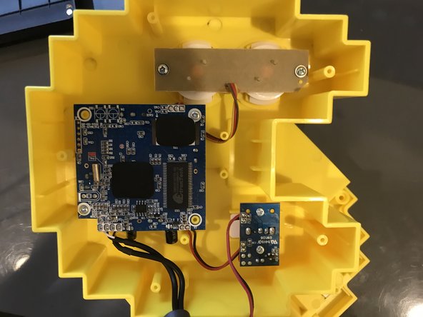

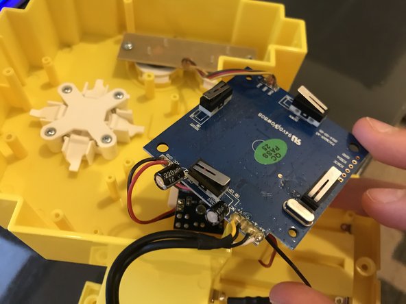

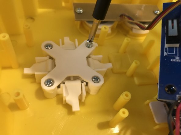

  4. Pac-Man Connect and Play Joystick Switchboard Replacement: crwdns2935265:04crwdnd2935265:01crwdnd2935265:01crwdne2935265:0
    • Remove these 2 screws (phillips)
  5. Pac-Man Connect and Play Joystick Switchboard Replacement: crwdns2935265:05crwdnd2935265:01crwdnd2935265:03crwdne2935265:0 Pac-Man Connect and Play Joystick Switchboard Replacement: crwdns2935265:05crwdnd2935265:02crwdnd2935265:03crwdne2935265:0 Pac-Man Connect and Play Joystick Switchboard Replacement: crwdns2935265:05crwdnd2935265:03crwdnd2935265:03crwdne2935265:0
    • You can now remove the board
    • You can, at this time, also remove the plastic X that holds the joystick spring in place.
