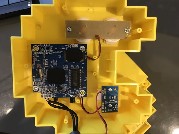

    • Begin by flipping the device over and removing the back cover
    • Ensure the device has no power, and isn't plugged into a television set.
  2. Pac-Man Connect and Play A or B Button Replacement: crwdns2935265:02crwdnd2935265:01crwdnd2935265:01crwdne2935265:0
    • Remove the 5 Phillips head screws
  3. Pac-Man Connect and Play A or B Button Replacement: crwdns2935265:03crwdnd2935265:01crwdnd2935265:02crwdne2935265:0 Pac-Man Connect and Play A or B Button Replacement: crwdns2935265:03crwdnd2935265:02crwdnd2935265:02crwdne2935265:0
    • You can now open the device.

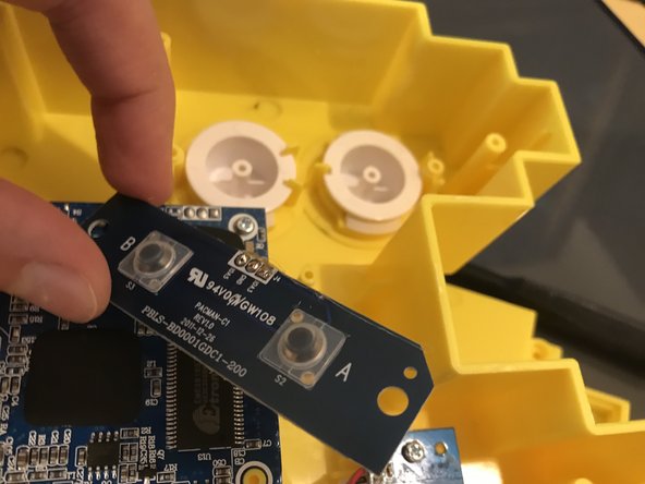

  4. Pac-Man Connect and Play A or B Button Replacement: crwdns2935265:04crwdnd2935265:01crwdnd2935265:02crwdne2935265:0 Pac-Man Connect and Play A or B Button Replacement: crwdns2935265:04crwdnd2935265:02crwdnd2935265:02crwdne2935265:0
    • Remove these 2 Phillips Head screws
    • Pull back the button board
  5. Pac-Man Connect and Play A or B Button Replacement: crwdns2935265:05crwdnd2935265:01crwdnd2935265:01crwdne2935265:0
    • You can now remove either (or both) buttons
