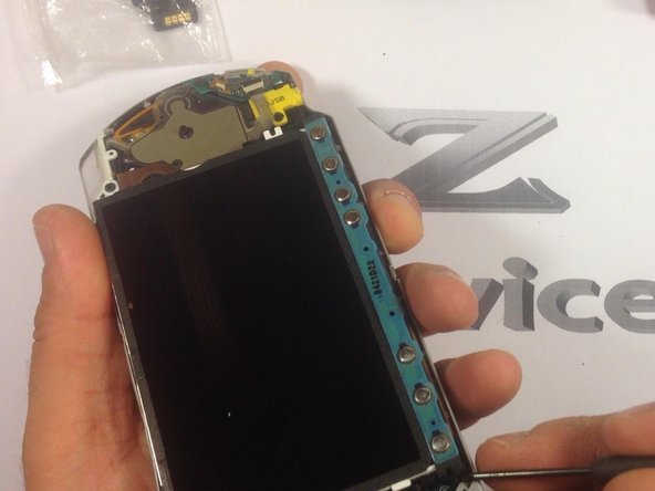

    • The plate with volume-start-home key flex.
  5. PSP 2000 Joystick / Analog Stick Replacement: crwdns2935265:05crwdnd2935265:01crwdnd2935265:03crwdne2935265:0 PSP 2000 Joystick / Analog Stick Replacement: crwdns2935265:05crwdnd2935265:02crwdnd2935265:03crwdne2935265:0 PSP 2000 Joystick / Analog Stick Replacement: crwdns2935265:05crwdnd2935265:03crwdnd2935265:03crwdne2935265:0
    • Be careful while removing the screen! Release the cables for screen and "volume-start-home keys"!

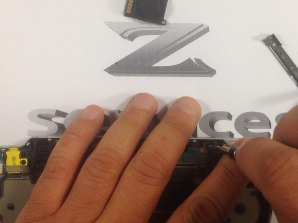

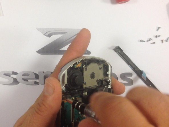

  7. PSP 2000 Joystick / Analog Stick Replacement: crwdns2935265:07crwdnd2935265:01crwdnd2935265:02crwdne2935265:0 PSP 2000 Joystick / Analog Stick Replacement: crwdns2935265:07crwdnd2935265:02crwdnd2935265:02crwdne2935265:0
    • Slightly lift the board and remove the joystick!
  8. PSP 2000 Joystick / Analog Stick Replacement: crwdns2935265:08crwdnd2935265:01crwdnd2935265:02crwdne2935265:0 PSP 2000 Joystick / Analog Stick Replacement: crwdns2935265:08crwdnd2935265:02crwdnd2935265:02crwdne2935265:0
    • Now is the time for the new replacement part.
