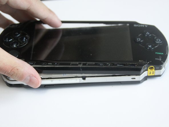

    5. PSP 1000 Motherboard Replacement: crwdns2935265:05crwdnd2935265:01crwdnd2935265:03crwdne2935265:0 PSP 1000 Motherboard Replacement: crwdns2935265:05crwdnd2935265:02crwdnd2935265:03crwdne2935265:0 PSP 1000 Motherboard Replacement: crwdns2935265:05crwdnd2935265:03crwdnd2935265:03crwdne2935265:0
      • Use a plastic opening tool to gently pry the face plate off of the device.
      • Be gentle when prying the face plate as you do not want to crack or scratch it.

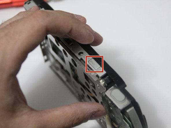

    13. PSP 1000 Motherboard Replacement, Note the conductive piece: crwdns2935265:013crwdnd2935265:01crwdnd2935265:03crwdne2935265:0 PSP 1000 Motherboard Replacement, Note the conductive piece: crwdns2935265:013crwdnd2935265:02crwdnd2935265:03crwdne2935265:0 PSP 1000 Motherboard Replacement, Note the conductive piece: crwdns2935265:013crwdnd2935265:03crwdnd2935265:03crwdne2935265:0
      • The midframe has a rectangular conductive piece that can fall out and be lost. Without it, the joystick won't work. Make sure to reinsert it so that the contacts on the conductive piece touches the pads.

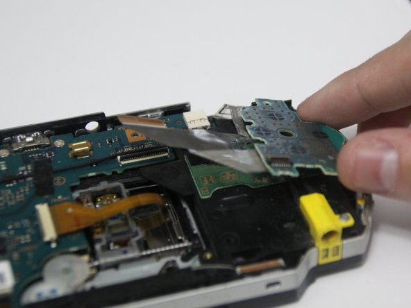

    15. PSP 1000 Motherboard Replacement: crwdns2935265:015crwdnd2935265:01crwdnd2935265:03crwdne2935265:0 PSP 1000 Motherboard Replacement: crwdns2935265:015crwdnd2935265:02crwdnd2935265:03crwdne2935265:0 PSP 1000 Motherboard Replacement: crwdns2935265:015crwdnd2935265:03crwdnd2935265:03crwdne2935265:0
      • Using a plastic opening tool, unlock the small black clip that is located underneath the circuit board.

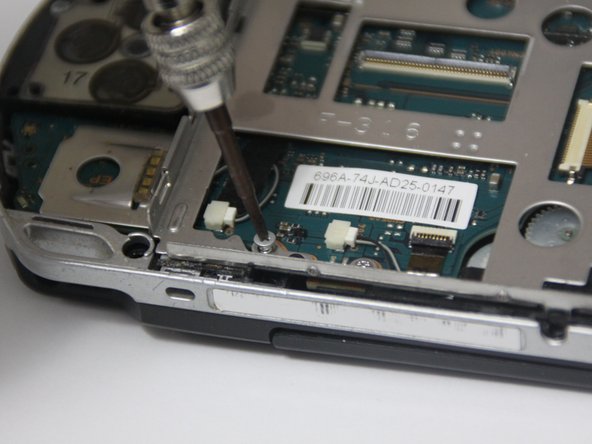

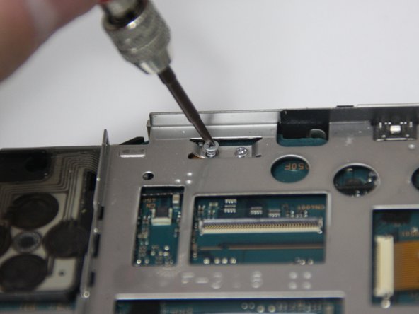

    22. PSP 1000 Motherboard Replacement: crwdns2935265:022crwdnd2935265:01crwdnd2935265:03crwdne2935265:0 PSP 1000 Motherboard Replacement: crwdns2935265:022crwdnd2935265:02crwdnd2935265:03crwdne2935265:0 PSP 1000 Motherboard Replacement: crwdns2935265:022crwdnd2935265:03crwdnd2935265:03crwdne2935265:0
      • Using the Phillips #00 screwdriver, remove the single 4.4 mm screw located on the top right of the motherboard.
