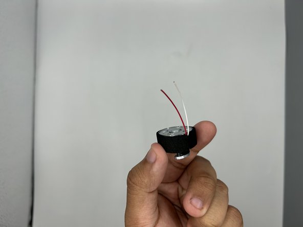

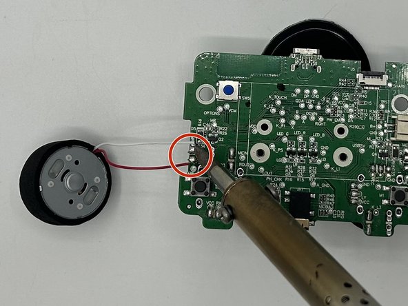

  7. PSKONTORORA LBER-P4-05 Vibration Motor Replacement, Vibration Motor: crwdns2935265:07crwdnd2935265:01crwdnd2935265:03crwdne2935265:0 PSKONTORORA LBER-P4-05 Vibration Motor Replacement, Vibration Motor: crwdns2935265:07crwdnd2935265:02crwdnd2935265:03crwdne2935265:0 PSKONTORORA LBER-P4-05 Vibration Motor Replacement, Vibration Motor: crwdns2935265:07crwdnd2935265:03crwdnd2935265:03crwdne2935265:0
    • Prop the motherboard up with a non-flammable material.
    • Carefully desolder each of the vibration motor motherboard connections.
    • Take note of which wires belong where.
    • Be sure to solder in a well-ventilated area and take appropriate safety precautions.
    • Remove the vibration motors.
