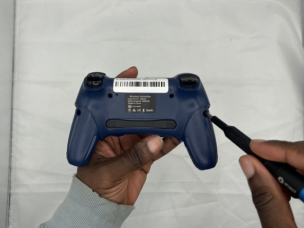

    • Remove the two 10 mm Phillips #1 screws that secure the grips.
    • Remove the grips.

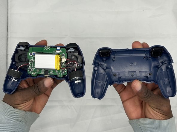

  3. PSKONTORORA LBER-P4-05 Touchpad Replacement: crwdns2935265:03crwdnd2935265:01crwdnd2935265:03crwdne2935265:0 PSKONTORORA LBER-P4-05 Touchpad Replacement: crwdns2935265:03crwdnd2935265:02crwdnd2935265:03crwdne2935265:0 PSKONTORORA LBER-P4-05 Touchpad Replacement: crwdns2935265:03crwdnd2935265:03crwdnd2935265:03crwdne2935265:0
    • Remove the four 9 mm Phillips #1 screws that secure the rear case.
    • Lift off the rear casing.

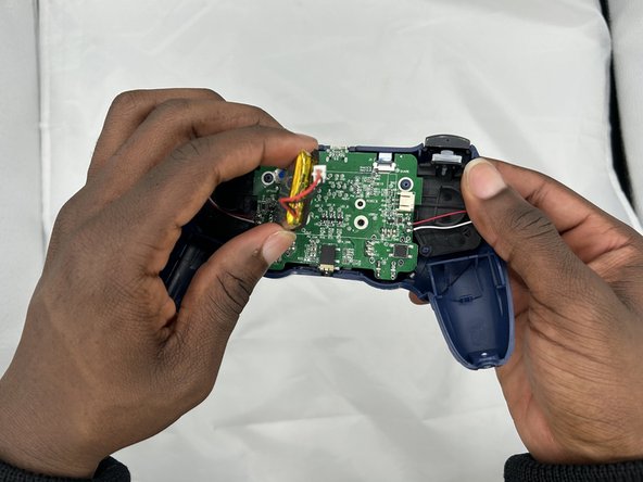

  4. PSKONTORORA LBER-P4-05 Touchpad Replacement: crwdns2935265:04crwdnd2935265:01crwdnd2935265:03crwdne2935265:0 PSKONTORORA LBER-P4-05 Touchpad Replacement: crwdns2935265:04crwdnd2935265:02crwdnd2935265:03crwdne2935265:0 PSKONTORORA LBER-P4-05 Touchpad Replacement: crwdns2935265:04crwdnd2935265:03crwdnd2935265:03crwdne2935265:0
    • Use tweezers to disconnect the battery from the motherboard.
    • Don't pull on the wires to disconnect the battery.
    • Gently lift the rumble motors out of their housings and set them beside the controller.
    • Take care not to strain or damage the cables.
    • Gently peel off the battery from the motherboard, with care not to bend or puncture the battery.

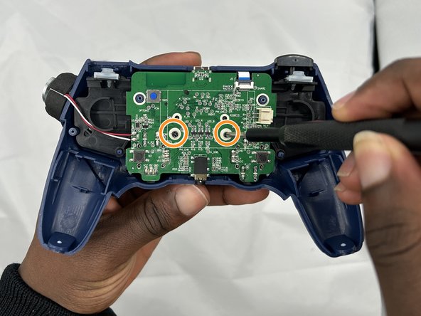

    • Remove the two 7 mm Phillips #1 screws that secure the motherboard.

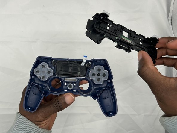

  5. PSKONTORORA LBER-P4-05 Touchpad Replacement: crwdns2935265:05crwdnd2935265:01crwdnd2935265:03crwdne2935265:0 PSKONTORORA LBER-P4-05 Touchpad Replacement: crwdns2935265:05crwdnd2935265:02crwdnd2935265:03crwdne2935265:0 PSKONTORORA LBER-P4-05 Touchpad Replacement: crwdns2935265:05crwdnd2935265:03crwdnd2935265:03crwdne2935265:0

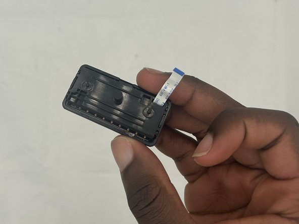

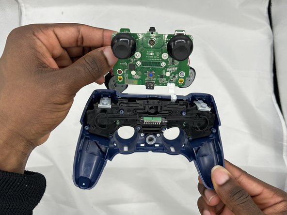

    • Flip up the black ZIF locking flap that secures the touchpad ribbon cable on the top-right edge of the motherboard.
    • Use tweezers or your fingers to gently disconnect the touchpad ribbon cable.
    • While pulling towards you, remove the motherboard.
    • Remove the black plate.

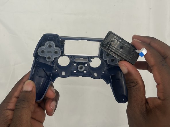

  6. PSKONTORORA LBER-P4-05 Touchpad Replacement: crwdns2935265:06crwdnd2935265:01crwdnd2935265:03crwdne2935265:0 PSKONTORORA LBER-P4-05 Touchpad Replacement: crwdns2935265:06crwdnd2935265:02crwdnd2935265:03crwdne2935265:0 PSKONTORORA LBER-P4-05 Touchpad Replacement: crwdns2935265:06crwdnd2935265:03crwdnd2935265:03crwdne2935265:0
    • Remove the touchpad.
