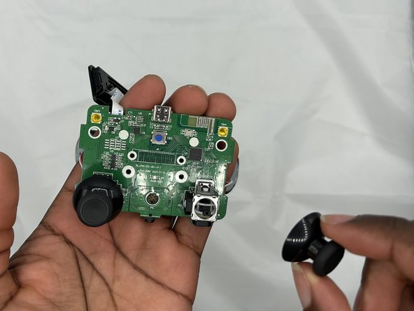

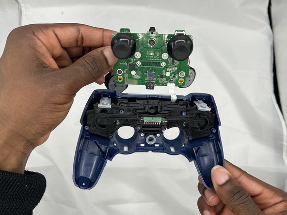

  4. PSKONTORORA LBER-P4-05 Joystick Covers Replacement, Joystick Covers: crwdns2935265:04crwdnd2935265:01crwdnd2935265:01crwdne2935265:0
    • Remove the two 7 mm Phillips #1 screws that secure the motherboard.
  5. PSKONTORORA LBER-P4-05 Joystick Covers Replacement: crwdns2935265:05crwdnd2935265:01crwdnd2935265:02crwdne2935265:0 PSKONTORORA LBER-P4-05 Joystick Covers Replacement: crwdns2935265:05crwdnd2935265:02crwdnd2935265:02crwdne2935265:0
    • Flip up the black ZIF locking flap that secures the touchpad ribbon cable on the top-right edge of the motherboard.
    • Use tweezers or your fingers to gently disconnect the touchpad ribbon cable.
    • Lift the motherboard up and out.
  6. PSKONTORORA LBER-P4-05 Joystick Covers Replacement: crwdns2935265:06crwdnd2935265:01crwdnd2935265:02crwdne2935265:0 PSKONTORORA LBER-P4-05 Joystick Covers Replacement: crwdns2935265:06crwdnd2935265:02crwdnd2935265:02crwdne2935265:0
    • Use your fingers to pull the joystick covers directly up and off the modules.
    • Clean or replace the joystick covers as necessary.
