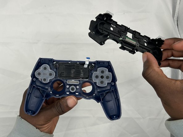

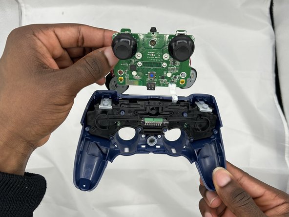

  4. PSKONTORORA LBER-P4-05 Buttons Replacement, Buttons: crwdns2935265:04crwdnd2935265:01crwdnd2935265:01crwdne2935265:0
    • Remove the two 7 mm Phillips #1 screws holding the board down.
  5. PSKONTORORA LBER-P4-05 Buttons Replacement: crwdns2935265:05crwdnd2935265:01crwdnd2935265:03crwdne2935265:0 PSKONTORORA LBER-P4-05 Buttons Replacement: crwdns2935265:05crwdnd2935265:02crwdnd2935265:03crwdne2935265:0 PSKONTORORA LBER-P4-05 Buttons Replacement: crwdns2935265:05crwdnd2935265:03crwdnd2935265:03crwdne2935265:0
    • Using tweezers, flip up the small black tab holding down the ribbon cable on the top right of the board and unplug the ribbon.
    • While pulling towards you, remove the motherboard.

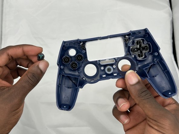

    • Remove the black plate in front of the buttons.
  6. PSKONTORORA LBER-P4-05 Buttons Replacement: crwdns2935265:06crwdnd2935265:01crwdnd2935265:02crwdne2935265:0 PSKONTORORA LBER-P4-05 Buttons Replacement: crwdns2935265:06crwdnd2935265:02crwdnd2935265:02crwdne2935265:0
    • Remove the silicon contact pads on the buttons.
