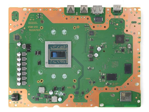

  1. PS5 Pro Chip ID, Main Board Side 1: crwdns2935265:01crwdnd2935265:01crwdnd2935265:02crwdne2935265:0 PS5 Pro Chip ID, Main Board Side 1: crwdns2935265:01crwdnd2935265:02crwdnd2935265:02crwdne2935265:0
    • Sony/AMD CXD90072GG/100-000000735 applications processor
    • Likely Sony CXD90069GG I/O controller
    • Winbond W25Q16JV 2 MB serial NOR flash memory
    • Infineon XDPE14286A multiphase controller
    • Texas Instruments TUSB1044 USB Type-C 10 Gbps bidirectional linear redriver
    • Likely Richtek USB Type-C redriver
    • Kioxia TH58LKT2T25BA8C 512 GB NAND Flash
  2. PS5 Pro Chip ID: crwdns2935265:02crwdnd2935265:01crwdnd2935265:02crwdne2935265:0 PS5 Pro Chip ID: crwdns2935265:02crwdnd2935265:02crwdnd2935265:02crwdne2935265:0
    • Richtek RT5126 power management
    • Richtek RT5127 power management
    • Monolithic Power Systems MP9162A synchronous step-down converter
    • Texas Instruments TPS2001D USB power-distribution switch

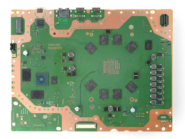

  3. PS5 Pro Chip ID, Main Board Side 2: crwdns2935265:03crwdnd2935265:01crwdnd2935265:02crwdne2935265:0 PS5 Pro Chip ID, Main Board Side 2: crwdns2935265:03crwdnd2935265:02crwdnd2935265:02crwdne2935265:0
    • Samsung K4ZAF325BC-SC20 2 GB GDDR6 SDRAM memory
    • SK hynix H5CG46AGBDX017N 2 GB DDR5 SDRAM memory
    • Sony CXD90070GG SSD controller
    • Samsung K4A4G085WF-BCTD 512 MB DDR4 SDRAM memory
    • Nuvoton MN864739 likely HDMI retimer
    • Infineon PMC41430 power stage
  4. PS5 Pro Chip ID: crwdns2935265:04crwdnd2935265:01crwdnd2935265:02crwdne2935265:0 PS5 Pro Chip ID: crwdns2935265:04crwdnd2935265:02crwdnd2935265:02crwdne2935265:0
    • Vishay SIC655A power stage
