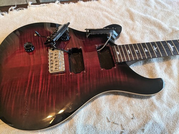

    • Loosen all of the strings until they can be pulled out of the tuners.
    • Pull the strings through the bridge and out of the back side of the guitar.
  2. PRS Guitar Pickups Replacement: crwdns2935265:02crwdnd2935265:01crwdnd2935265:02crwdne2935265:0 PRS Guitar Pickups Replacement: crwdns2935265:02crwdnd2935265:02crwdnd2935265:02crwdne2935265:0
    • Using a Phillips head screwdriver, unscrew the back plate, revealing the pickup wiring.
  3. PRS Guitar Pickups Replacement: crwdns2935265:03crwdnd2935265:01crwdnd2935265:01crwdne2935265:0
    • Take note of the wiring before desoldering the wires.
    • Begin desoldering the pickup wires.
    • Take care when soldering, as the tip is very hot.
  4. PRS Guitar Pickups Replacement: crwdns2935265:04crwdnd2935265:01crwdnd2935265:02crwdne2935265:0 PRS Guitar Pickups Replacement: crwdns2935265:04crwdnd2935265:02crwdnd2935265:02crwdne2935265:0
    • Turn the guitar face up and unscrew both of the pickups.
    • Take the pickups out of the guitar.
  5. PRS Guitar Pickups Replacement: crwdns2935265:05crwdnd2935265:01crwdnd2935265:02crwdne2935265:0 PRS Guitar Pickups Replacement: crwdns2935265:05crwdnd2935265:02crwdnd2935265:02crwdne2935265:0
    • Refer to the wiring arrangements you took note of as well as the wiring manual that came with your new pickups.
    • Run the new pickups back through the guitar with the wires guided through the back plate.
    • Carefully begin soldering the new pickup wires back together.
  6. PRS Guitar Pickups Replacement: crwdns2935265:06crwdnd2935265:01crwdnd2935265:01crwdne2935265:0
    • This is a good opportunity to clean the guitar.
    • Begin restringing the guitar with new strings of your preference.
    • Using a string/wire cutter and cut excess strings from tuners.
