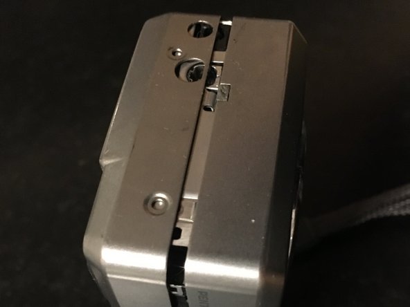

  1. PENTAX OPTIO 330 Internal Battery replacement, Remove rear bloc: crwdns2935265:01crwdnd2935265:01crwdnd2935265:01crwdne2935265:0
    • remove the two 2.5mm screw of the left side
  2. PENTAX OPTIO 330 Internal Battery replacement, Remove rear bloc: crwdns2935265:02crwdnd2935265:01crwdnd2935265:01crwdne2935265:0
    • Remove two 4mm screw of the right side

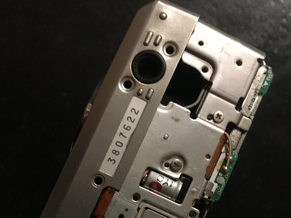

  3. PENTAX OPTIO 330 Internal Battery replacement, Remove rear bloc: crwdns2935265:03crwdnd2935265:01crwdnd2935265:01crwdne2935265:0
    • remove 2mm screw
    • remove 3mm screw
    • remove the three 3.5mm screw

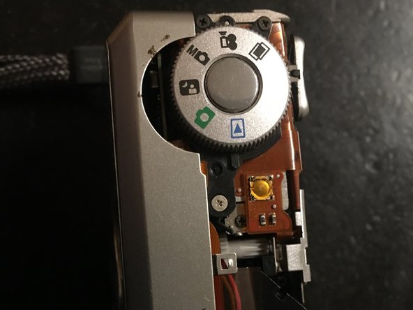

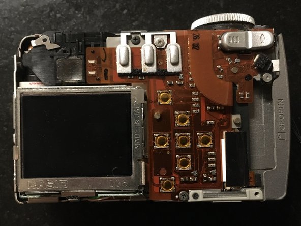

  4. PENTAX OPTIO 330 Internal Battery replacement, Remove rear cover: crwdns2935265:04crwdnd2935265:01crwdnd2935265:03crwdne2935265:0 PENTAX OPTIO 330 Internal Battery replacement, Remove rear cover: crwdns2935265:04crwdnd2935265:02crwdnd2935265:03crwdne2935265:0 PENTAX OPTIO 330 Internal Battery replacement, Remove rear cover: crwdns2935265:04crwdnd2935265:03crwdnd2935265:03crwdne2935265:0
    • Open the memory protection
    • Remove gently the rear cover
    • When re-assembly take care to the thin tabs

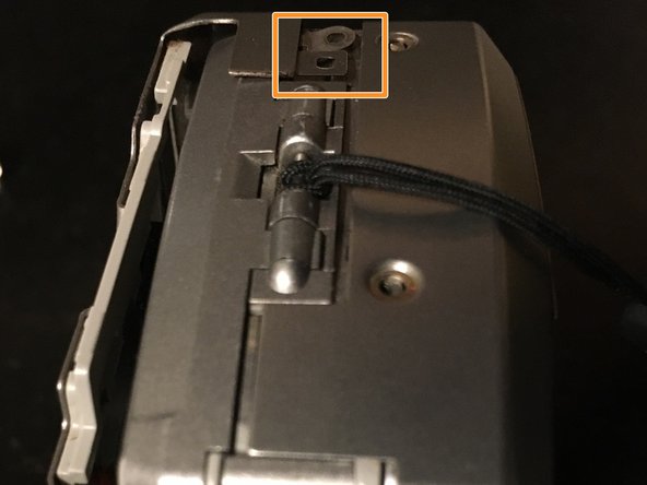

  5. PENTAX OPTIO 330 Internal Battery replacement, Remove rear cover: crwdns2935265:05crwdnd2935265:01crwdnd2935265:02crwdne2935265:0 PENTAX OPTIO 330 Internal Battery replacement, Remove rear cover: crwdns2935265:05crwdnd2935265:02crwdnd2935265:02crwdne2935265:0
    • this part can fall down. So rome it before next step.

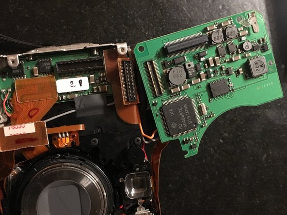

  7. PENTAX OPTIO 330 Internal Battery replacement: crwdns2935265:07crwdnd2935265:01crwdnd2935265:01crwdne2935265:0
    • Remove four screw
    • unplug the two Flex
  8. PENTAX OPTIO 330 Internal Battery replacement, Battery replacement: crwdns2935265:08crwdnd2935265:01crwdnd2935265:02crwdne2935265:0 PENTAX OPTIO 330 Internal Battery replacement, Battery replacement: crwdns2935265:08crwdnd2935265:02crwdnd2935265:02crwdne2935265:0
    • This connector is directly to the board
    • This Flex connector need to be unplug
    • The 321 battery is there
    • You can add some thermal glue to fix the battery
    • I did it with a small piece of scotch
To re-assembly your device follow the step backward
