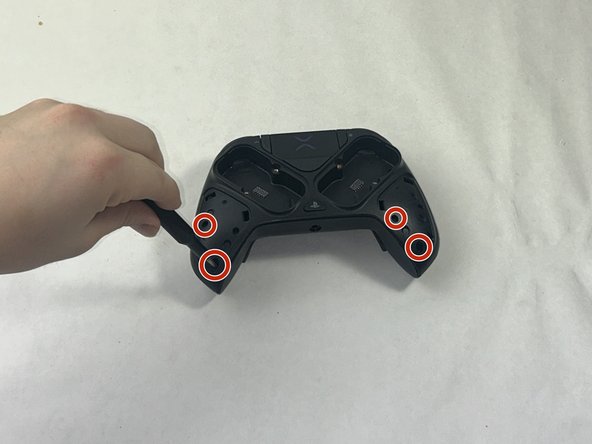

    • Use the purple Module Swap Tool that comes with the device to remove the 4 hex screws.
    • Remove the joystick/button modules from the controller.
  2. PDP Victrix Pro BFG Headphone Jack Replacement: crwdns2935265:02crwdnd2935265:01crwdnd2935265:01crwdne2935265:0
    • Remove the two screws from the module compartments.
  3. PDP Victrix Pro BFG Headphone Jack Replacement: crwdns2935265:03crwdnd2935265:01crwdnd2935265:02crwdne2935265:0 PDP Victrix Pro BFG Headphone Jack Replacement: crwdns2935265:03crwdnd2935265:02crwdnd2935265:02crwdne2935265:0
    • Using the iFixit opening tool, gently pry open the two side grips.
    • Using the screwdriver tool with a head of around 2 mm, remove the screws located in the bottom outside corners.
