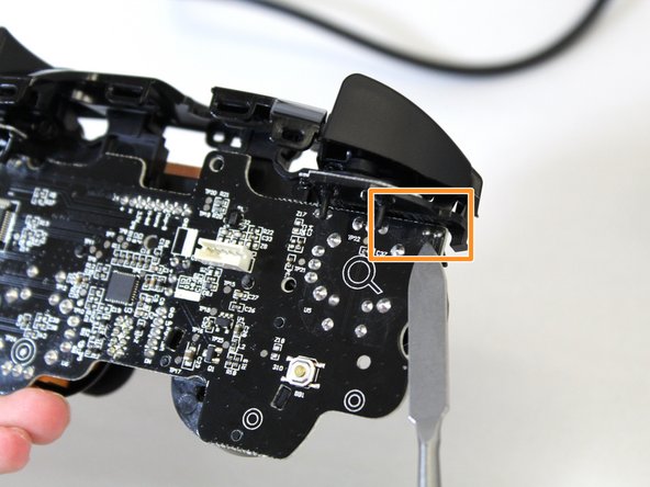

    1. PDP Rematch Top Left and Right Button(s) Replacement, Top Left and Right Buttons: crwdns2935265:04crwdnd2935265:01crwdnd2935265:02crwdne2935265:0 PDP Rematch Top Left and Right Button(s) Replacement, Top Left and Right Buttons: crwdns2935265:04crwdnd2935265:02crwdnd2935265:02crwdne2935265:0
      • Remove the back panel by pulling it away from the front.
      • Disconnect the cable by squeezing the two sides while pulling the cable away from the motherboard.

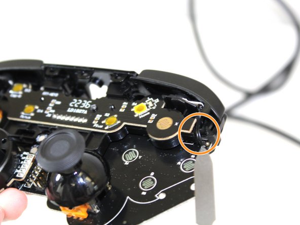

    2. PDP Rematch Top Left and Right Button(s) Replacement: crwdns2935265:05crwdnd2935265:01crwdnd2935265:02crwdne2935265:0 PDP Rematch Top Left and Right Button(s) Replacement: crwdns2935265:05crwdnd2935265:02crwdnd2935265:02crwdne2935265:0
      • Touch the hot tip of the soldering iron to the first solder connecting the buttons to the motherboard until the solder melts.
      • Repeat this for the next solder. Verify solders have detached from motherboard.
      • Be careful of the hot soldering tip.

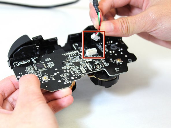

    3. PDP Rematch Top Left and Right Button(s) Replacement: crwdns2935265:06crwdnd2935265:01crwdnd2935265:02crwdne2935265:0 PDP Rematch Top Left and Right Button(s) Replacement: crwdns2935265:06crwdnd2935265:02crwdnd2935265:02crwdne2935265:0
      • When the solder has completely melted, flip the controller and gently pull the wire free from the motherboard.
      • Repeat for the other black wire.
