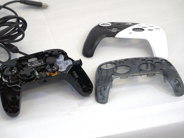

    • Grip one side of the controller firmly.
    • Insert an opening pick into the crease between the faceplate and the body of the controller.
    • Once the pick creates a gap in the crease, gently insert another pick into a different section of the crease.
    • Carefully move the picks along the controller's crease line until you hear a popping sound.
    • Gently lift off the faceplate by hand.
  2. PDP Rematch Joystick Cover Replacement: crwdns2935265:02crwdnd2935265:01crwdnd2935265:02crwdne2935265:0 PDP Rematch Joystick Cover Replacement: crwdns2935265:02crwdnd2935265:02crwdnd2935265:02crwdne2935265:0
    • Remove the 8 mm screws from the hard cover using a JIS #00 screwdriver.
    • Since the screws have been removed, avoid shaking or moving your controller too much to prevent other buttons from falling out.
  3. PDP Rematch Joystick Cover Replacement: crwdns2935265:03crwdnd2935265:01crwdnd2935265:02crwdne2935265:0 PDP Rematch Joystick Cover Replacement: crwdns2935265:03crwdnd2935265:02crwdnd2935265:02crwdne2935265:0
    • Gently lift off the hard cover with your hand; it should not need much force.
  4. PDP Rematch Joystick Cover Replacement, Joystick Cover: crwdns2935265:04crwdnd2935265:01crwdnd2935265:01crwdne2935265:0
    • The action buttons and silicone pad are loose and may fall out of the controller.

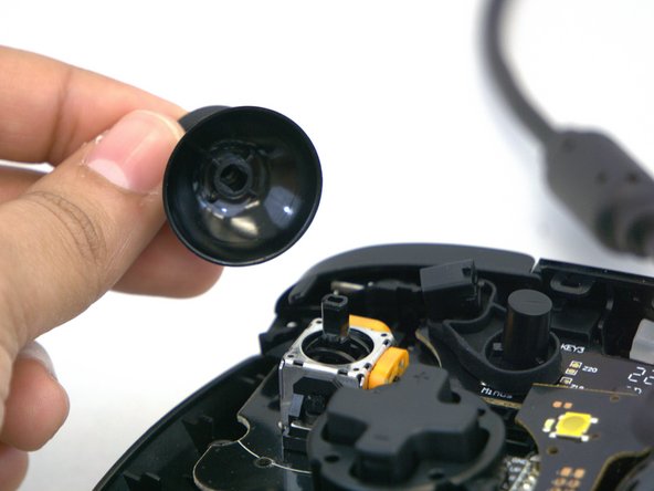

  5. PDP Rematch Joystick Cover Replacement: crwdns2935265:05crwdnd2935265:01crwdnd2935265:02crwdne2935265:0 PDP Rematch Joystick Cover Replacement: crwdns2935265:05crwdnd2935265:02crwdnd2935265:02crwdne2935265:0
    • Gently rotate or twist the joystick(s) you want to replace.
    • Apply some force and pull upward towards you.
    • You will know it is released when you hear a popping sound.
    • Place your new joystick and push it downwards; you will hear a popping sound again.
