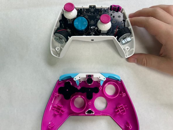

  2. PDP Rematch Advanced Triggers Replacement: crwdns2935265:02crwdnd2935265:01crwdnd2935265:02crwdne2935265:0 PDP Rematch Advanced Triggers Replacement: crwdns2935265:02crwdnd2935265:02crwdnd2935265:02crwdne2935265:0
    • Pull apart the controller's front and back shells with moderate force.
    • Orient the controller so that the front shell is facing the floor to prevent the face buttons from falling out.

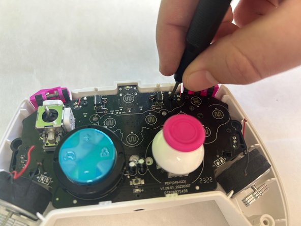

  3. PDP Rematch Advanced Triggers Replacement: crwdns2935265:03crwdnd2935265:01crwdnd2935265:02crwdne2935265:0 PDP Rematch Advanced Triggers Replacement: crwdns2935265:03crwdnd2935265:02crwdnd2935265:02crwdne2935265:0
    • Use a Phillips #00 screwdriver to remove the two 5 mm screws that secure the motherboard.

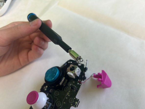

  5. PDP Rematch Advanced Triggers Replacement: crwdns2935265:05crwdnd2935265:01crwdnd2935265:02crwdne2935265:0 PDP Rematch Advanced Triggers Replacement: crwdns2935265:05crwdnd2935265:02crwdnd2935265:02crwdne2935265:0
    • Use a Phillips #00 screwdriver to remove the two trigger springs from the motherboard.

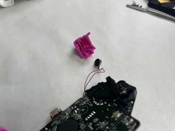

    • Use a hair dryer to remove the trigger from the motherboard.
